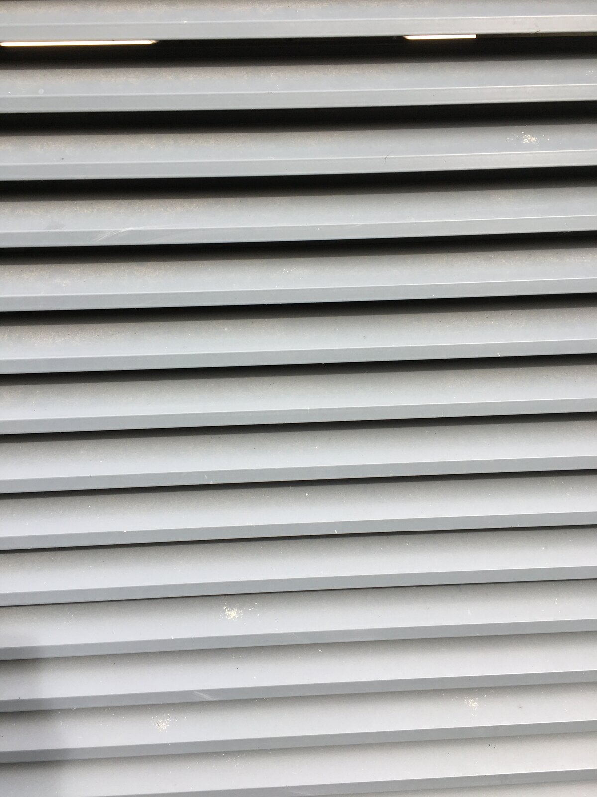

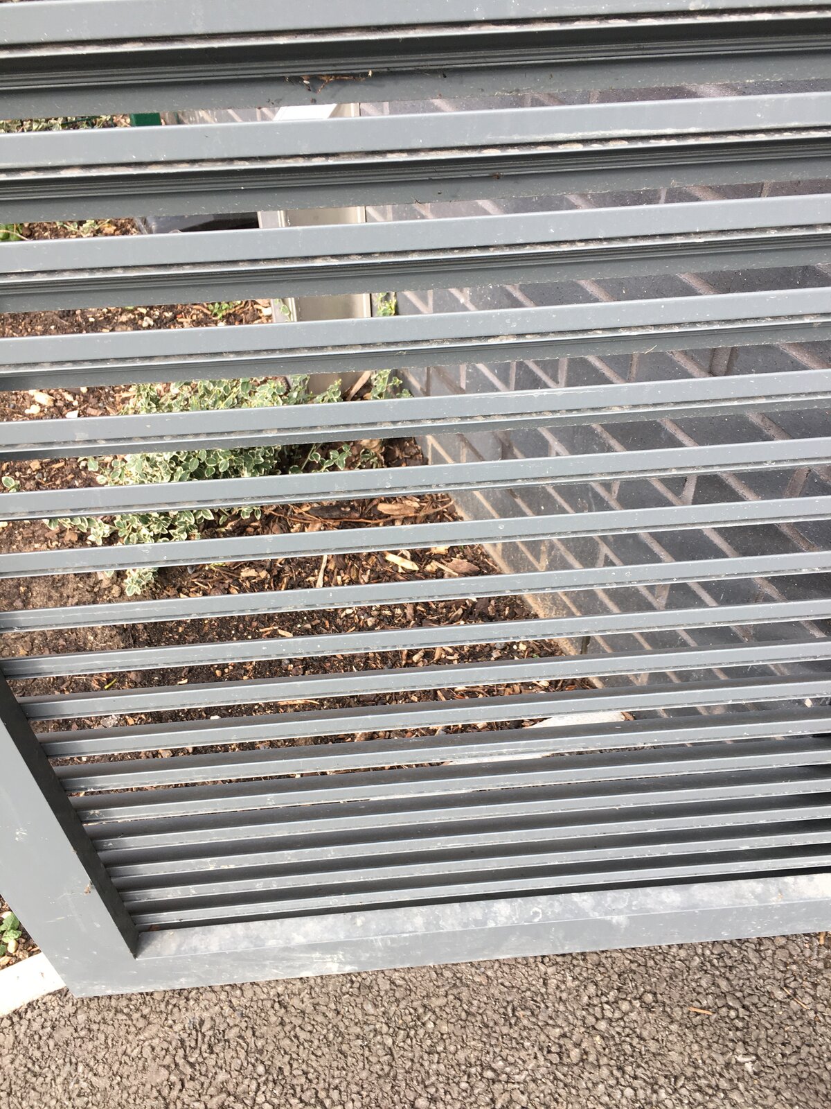

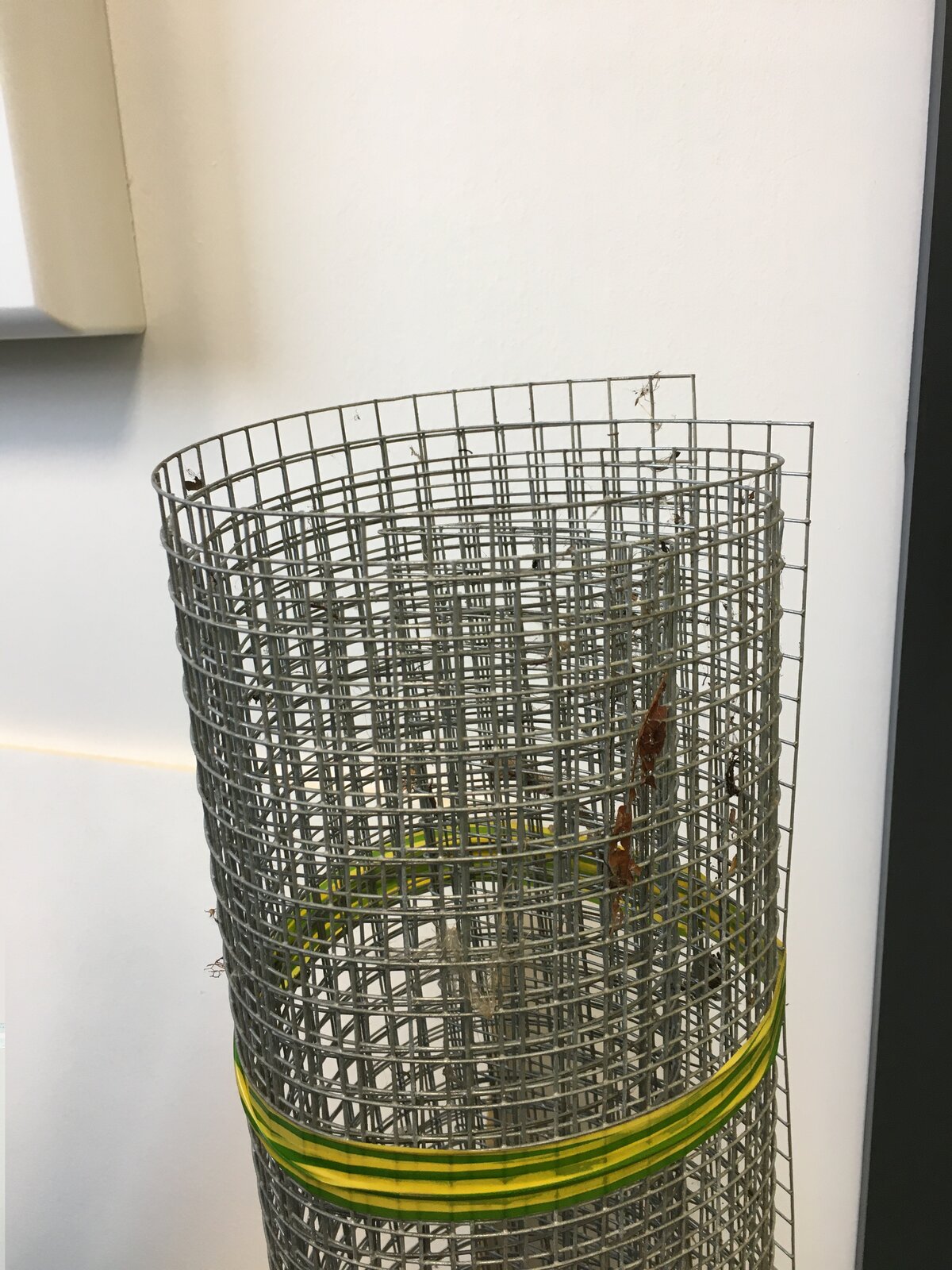

Some pictures. The holes in the mesh are measuring 12mm square so clearly vermin proofing rather than fly screen.
The louvres are shown from the outside and inside. I think the length of the mesh will only reach to mid door height anyway but the louvres are full height so it seems he is talking hot air.
Well, in my opinion, he took it off he can come and put it back on. Not even sure how it was fixed on because there are no screw holes or evidence of some form of sticky adhesive. :confused:
