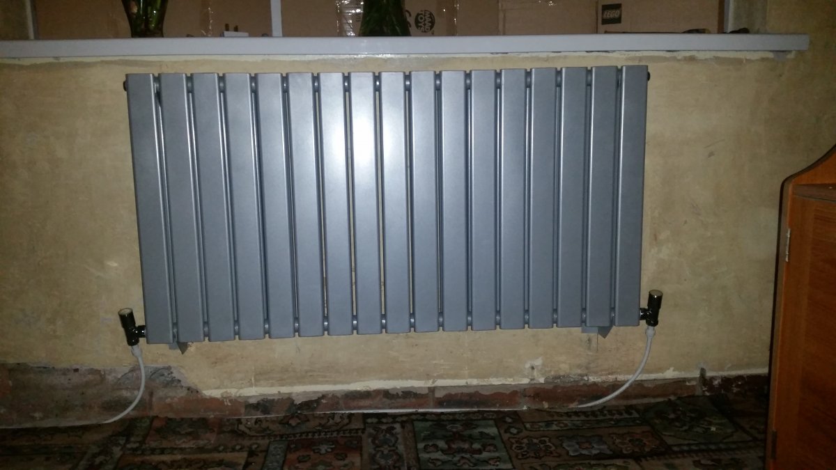

The plumber has been and im not impressed, can I have your views? He said that he cant fully put the plastic pipe in the wall as there is no way to fix it to the brick and it keeps popping out. Therefore he said the skirting boards would have to be notched out and pipe visable up the wall, not the result I wanted.
Here is a photo
I use strapping band, cut 5 holes long, fixed with a 2" screw in the middle hole and bent over the pipes (10mm copper covered in duct tape). Never had a problem other than customers drilling through the pipes for curtains poles or tie-backs.
Oh my, nearly fell off the settee. That's why I would use coated copper and at least formed bends. Visible plastic looks pants.
Oh dear, that's not the cleverest.
yes it can be fixed, get a new plumber who is prepared to do the proper work and chase the walls and put in copper. Even if it is the plastic he could use 10mm saddle clips or twin clips, easily fixing it to the brick, sounds like this guy doesn't want to get creative at all.
