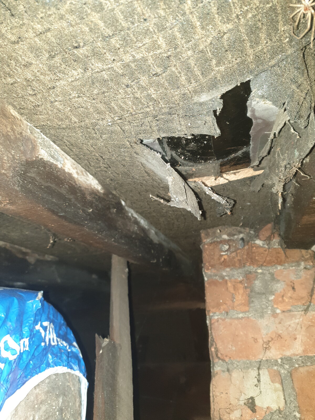

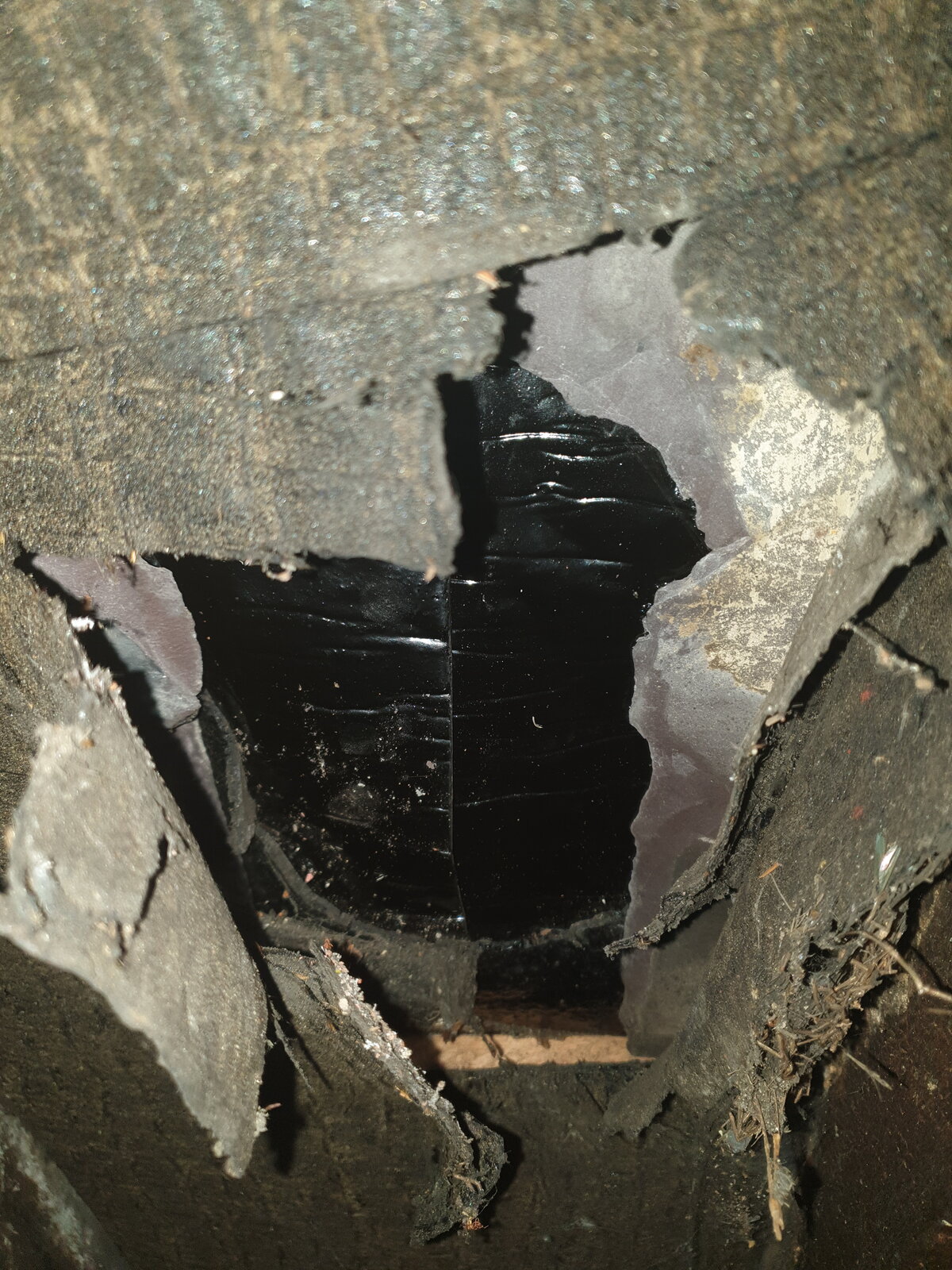

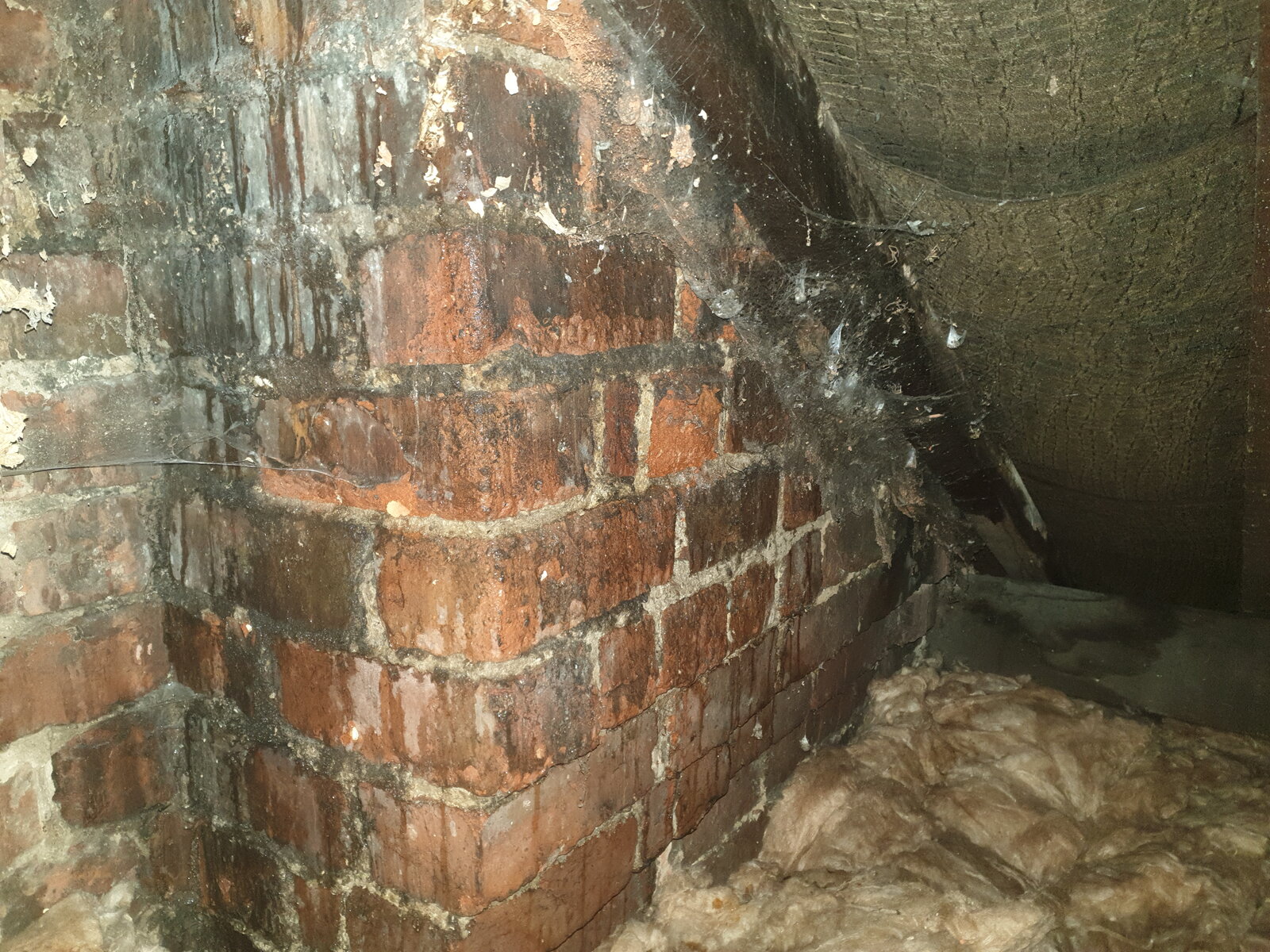

A few questions. I'm in top floor flat of Edwardian house. Water came through ceilings this week so I climbed up into attic to investigate. Found water coming down chimney breast and roof joist soaked first pic). No sunlight coming through but slates hidden by old roof felt. I did however find an area further up same wall next to a second chimney stack where felt had been ripped or pushed open. Found what looks like plastic sheet under/ above possibly broken slates. Has anyone seen this before? Freeholder had some cowboy builders replace barge boards and capping boards last Summer but we weren't allowed to inspect the work and no idea what they did. Expecting them back to investigate leak but can they do this from inside?

I imagine it hasn't got led flashing around the chimney and is mortar flashing, maybe the mortar has failed.

I think I see broken edges of slates and a gap where there are no slates at all. The gap being covered with what appears to be some thick sticky back black plastic material. If I am right it is a complete botched job, typical of the cowboys. It cannot be fixed from inside, ladders and maybe even scaffolding to access it.
Thanks. That's what I suspected. The hatch to the roof appears to have been sealed shut since the work was done in Summer so I can't take a look at the chimney stack. 3 storeys high at the front 4 at the back so ladders won't reach. When the work was scheduled we were told that the chimney stacks were going to be scaffolded for an inspection and quotes provided for additional work but that never happened...have water dripping down the larger stack when it rains even though there is a cowling on top. Another indication that they need repairing.
Not an acceptable repair. Don't pay the service charge for any new repair, and negotiate a reduction/refund from previous charge. Plus claim the cost of internal repairs from the landlord.
Can't be repaired from inside.
