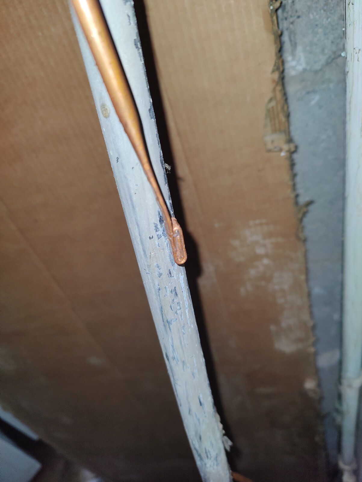

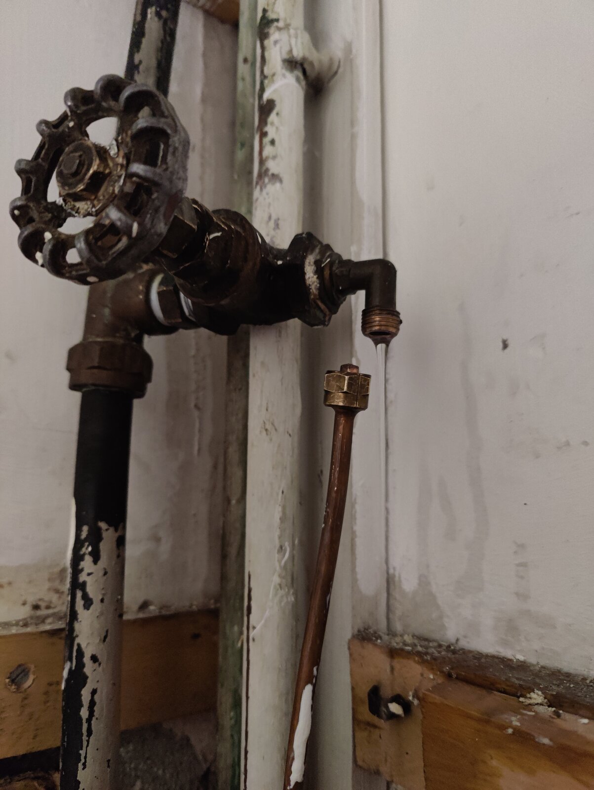

I'm trying to disconnect an old fridge freezer which is plumbed in through a 6mm copper pipe, which is connected to a valve...a very old valve. The Valve wont close completely, leaving a drip. I'm trying to find something i can screw in place of the copper pipe to stop the water. Any help would be greatly appreciated. I'm not confident enough to try and get rid of the valve completely on my own, so some type of stopper that I can screw on would be ideal until we get the kitchen renovated.
Regards Sean
With old obscure fittings like that then the old school approach can sometime be the best. Are you using the copper pipe that's been disconnected? If not cut the pipe say 100mm odds long then fold over 20mm of the end and hammer it totally flat and then do it again working your way up towards the nut. By the time you get to the nut the copper should be folded enough times to seal the end, then put it back on the tap and do it up.
Ideally, you would solder the end then flatten it.
Would Gorilla glue do the trick instead of solder?
There is at least a meter or more of copper pipe to work with, and no i'm not keeping it. We've bought a brand new LG fridge freezer, unplumbed. I'm just looking for a quick fix until we sell our old house, then we will be getting a Kitchen extension and ripping out all the old stuff.
Nope
Or as was suggested, if you have the tools, take the reducer/elbow out of the end of the tap and fit one of these with some tape/fibre washer on it -
22863_P

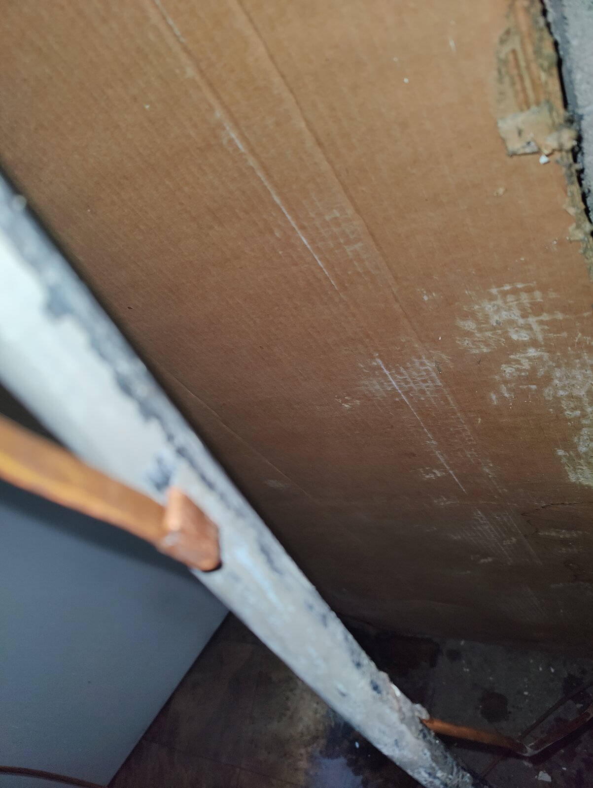

Tools are an issue. I bought a tube of fernox ls-x, and when I finish work I'm going to fold the pipe like a Japanese sword. I'll then cake the end in the leak sealer
Jobs a goodun. Thanks Madrab. Getting my solution from a fellow Scotsman was icing on the cake
