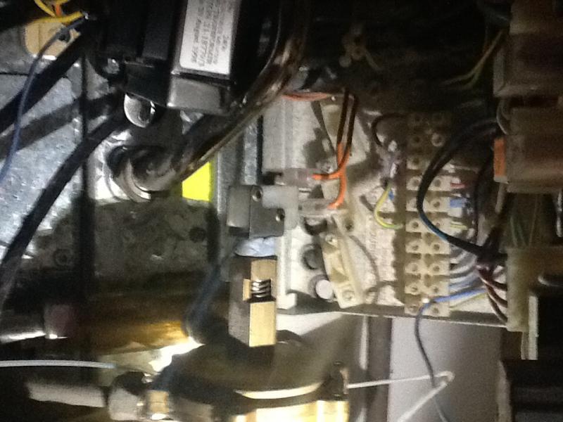

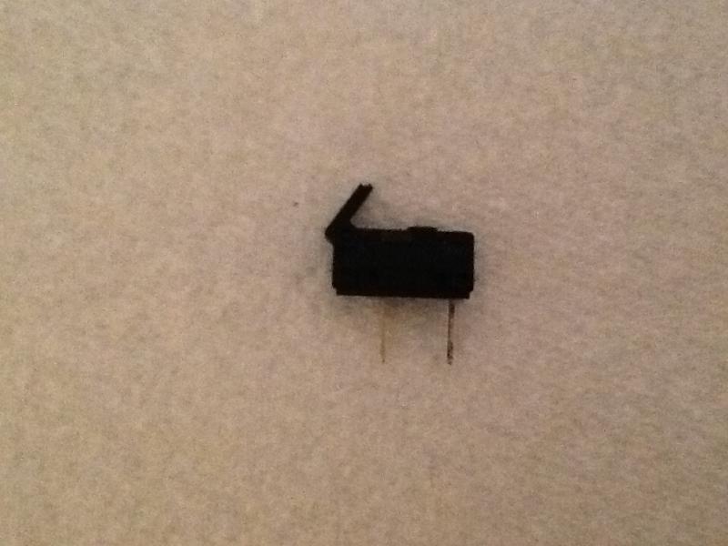

Hello, recently moved into my first house so all this is new to me, I have power to the boiler but no led indicators on front I tested the fuse and it's fine when I opened up the boiler I found this laying in behind the pcb which has thrown me
Congrats! You found a random microswitch! :confused:

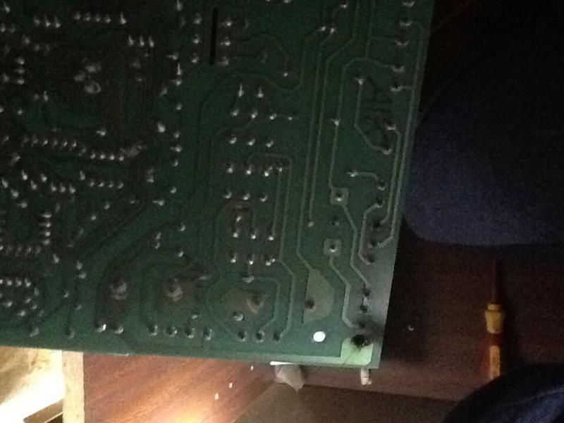

Combi 80 a.k.a. Potterton Puma notorious for circuit board burning out at the top left where the power goes in.
If you have no lights as you say then that would be the first place I would be checking.
Thank you for your reply, god knows where the micro switch came from but where I found it there was a few dead fuses with it so maybe it's been replaced an just left in there (I hope) I'm gonna replace the pcb 1st then from what I've read and own (limited) knowledge!!
You could take a look at the board first, the fault is a dry joint on the neutral wire which is pretty easy to resolder if it hasn't burnt the board out yet.

But its an easy repair job on the OP's unit for someone experienced at soldering.

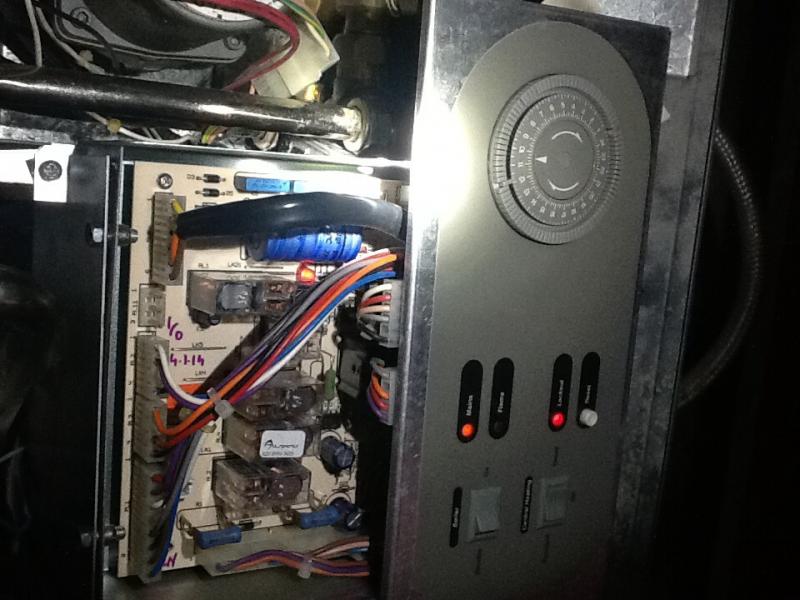

Ok update worked out the dhw flowswitch wasn't in the correct position adjusted all working fine now thank you for all your help!!!!
