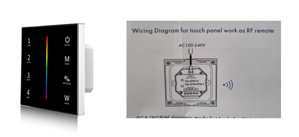

Hi all. Hope everyone's well.
I'm wanting to add a second lighting circuit to my bathroom controlled by a different switch (this will be for LEDs). I've bought a touch control switch which lets me choose colours/brightness etc. I'm planning to locate the new switch on the wall just below the existing light switch so my question is this if someone could offer advice - can I power the new light switch using a short cable link from the power feed terminals on the existing switch above? (I've got a three core feed into the existing switch).
I've attached a photo below of the new switch and the wiring diagram which just calls for a live and neutral into it.

Then, yes, you can connect L & N to the new switch.

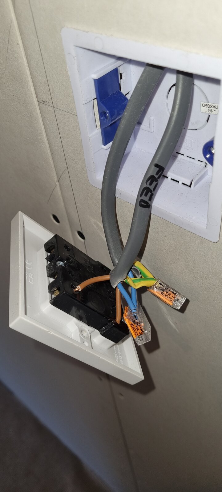

Thanks. So would it just be a case of running two individual strands from existing switch to new switch, I.e neutral-neutral and live-live? I take it I wouldn't need to keep them together in the grey coating with an earth strand? Or would I? :unsure: sorry if that's a mega stupid question :confused:
Yes, but there is no neutral at the existing switch - just in the connector with the blue wires.
Plus the appropriate brown from the feed cable.
Strictly speaking it should be a piece of cable with sheathing (grey coating) as it will be going from one backbox to another - so not a stupid question
Oh, and you don't really need the earth wire.
Normally the earth wire should never be cut but as it will be only a few inches and easily replaceable should it ever be needed, you may as well pull it out.
Others might disagree.
