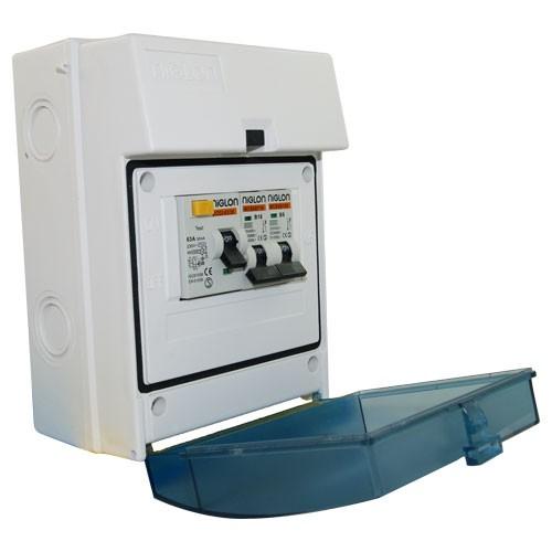

Hi Folks, hoping someone can help with an issue I am having relating to my shower unit. Last night I switched on our power shower that has been fine for the past 2-3 years but is used extensively and it sort of struggled for a split second and died along with all the lights upstairs as well. The consumer unit downstairs is all still on with nothing tripped including the RCD. A freind who is an electrician came over and narrowed it down to a fault with the RCD that is attached to the shower and upstairs lighting. Firstly it wont trip when you test it and he also measured power into the RCD but found that there was no output which supplies the upstairs and explains why I dont have lights or shower power. He seems to think a replacement RCD is needed.
He did mention he could try and clean it up and give it another go but reccomnded I purchase a new one. I guess my question is.....has anyone experienced anyhthing similar and what was the solutions
