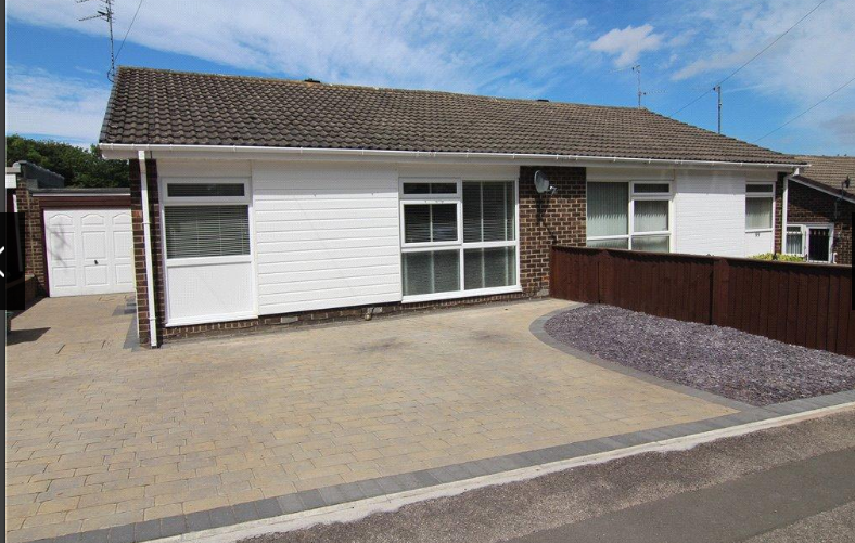

In the process of buying this property for elderly parents.
It's not located on a classified road.

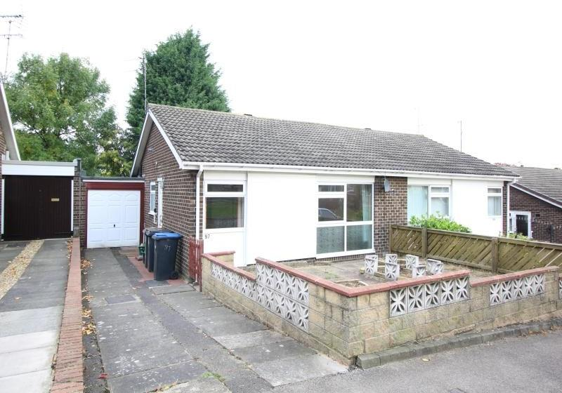

Current owners have replaced the gravel and paving stone driveway and walled ?paving and gravel front garden since they bought in 2016.
The BP is only 1 brick below the DP course and best practice is 2 bricks.(see photo)
We have no reason to think it's permeable construction and there are no drains set into the BP.
No Planning permission.
There's a downspout on the front corner and also a semi circular area of slate to the right hand side of the BP but other than the drain for the bathroom waste water along the side of the house close to the garage door there's nothing else in the way of soakaway.
They haven't extended the dropped kerb beyond the original driveway.
The driveway once past the front corner of the house is too narrow for a car to park on (unless you can get out via the roof!) and would find it difficult to use the existing drop kerb to park 2 vehicles. Curently the owners must be bumping up over the kerb to park on the newly created area.
Following enquiry by solicitor re the construction of the BP the sellers have disclosed the name of the contractor who carried out the work but haven't offered details of a guarantee and say they don't have an invoice. Looking at the contractors website it states they provide a 10 yr guarantee against subsidence.
According to local council website they require everyone to contact the council if they intend to make any amendmenents to or create new driveways/parking areas, even if it subsequently doesn't require PP. They also say that when you apply for a license to drop a kerb for a new driveway/parking you have to submit evidence that the planning dep't have been contacted re the work.
Our concerns are
1. the height of the BP in relation to the DP, especially as there are no drains set into the BP and it doesn't seem to be permeable
2. whether the sellers contacted the council before the work
3. if when we contact the council to extend the drop kerb they'll say the BP isn't correctly constructed and should have had PP and tell us to rip the whole thing up which would be costly.
4. No documentation /guarantee
Is it worth contacting the council and asking solicitor to get the owners to verify with the company re the 10 yr guarantee ?

If the bricks are of reasonably good quality (are any shaled near ground level?), the BP being within 1 course of the dpc shouldn't be a problem.
For the BP, it is of course necessary to apply for planning permission for any new hardstanding greater than 5 sq m and forward of the front elevation if it is not permeable or does not drain to a soakaway within the site. There is no obligation to inform the council if you enlarge a hardstanding, regardless of what it states on the website.
Planning permission is also required to widen an existing dropped kerb.
After 4 years has elapsed, the council can take no enforcement action on the BP, even though it doesn't comply. If you like the property and buy it, just keep quiet about the BP, and don't apply for a dropped kerb until after 4 years has elapsed since the BP was done (does the vendor have a receipt showing the date of the work?).

The works are more likely to be notifiable for building control than planning.
As long as all the drive slopes away from the house it is not too much of a problem, you could just take the edging blocks out around the house to get the 150mm. The 150mm in this instance is mainly designated as a "splash zone" and on a cavity wall is unlikely to cause any problems as water splashing up will contained to the outer leaf. Also as the bricks below the DPC look to match the house,I would expect them to be able to take water/frost attack etc. and the large eaves overhang will minimise splash in this area anyway.
The driveway definitely doesn't slope towards the road.Possibly the front area is sloping slightly to the left (towards the original driveway- which looking at the before photo where it looks like that area was higher than the drive makes sense). The drive definitely has a slight downslope. I understood (from the website of the contractor who did the work) that the purpose of the dark grey edging stones is to prevent the blocks moving but wonder how that works. Are they laid differently from the others?
We're wondering about an indemnity policy which would at least cover us against any enforcement but wouldn't solve the potential for run off towards the house and damp. Then I read that if there was an indemnity policy in place and we contacted the local council to ask for permission to drop the kerb the policy would be invalidated as we will be bringing the new block paving with no PP to the attention of the council.
Th
If your road is not classified (or what they strangely call a "classified un-numbered road" - perhaps an avenue serving only local residents?) you would not need planning permission to lower the kerb, though you would probably need approval from the local Highways dept. Whether they would liase with Planning is anyone's guess.
An indemnity policy is void if the council is aware of the work; it would also only cover for legal expenses appealing an Enforcement Notice, not the cost of putting the work right
Correct re the indemnity policy. But there's no need to ask for retrospective permission... the point of the indemnity is that you do nothing and then if the council raise as an issue the policy picks up the cost of the mess.
Lovely neat job. The new hardstanding/ drive doesn't need planning permission as it falls well within the Permitted Development rights applicable to residential dwellings. I don't care what the council website says about contacting them I wouldn't bother. If it doesn't need planning permission it doesn't need it. They have no powers to make you contact them and they can't enforce on something that doesn't need permission in the first place.
With regard to the dropped kerb issue Tony is correct in saying that this isn't a Planning issue. This a Highways Authority matter IF the road is an adopted highway. If the road is private you could ask the neighbours what the local arrangement/ procedures are.
