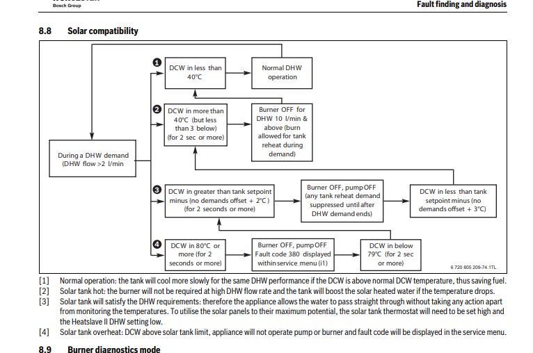

So looking at the manual for my Greenstar Heatslave II Oil Combi, it seems it can take pre heated water. Looking at the table, I guess it needs to be over 40C right?
