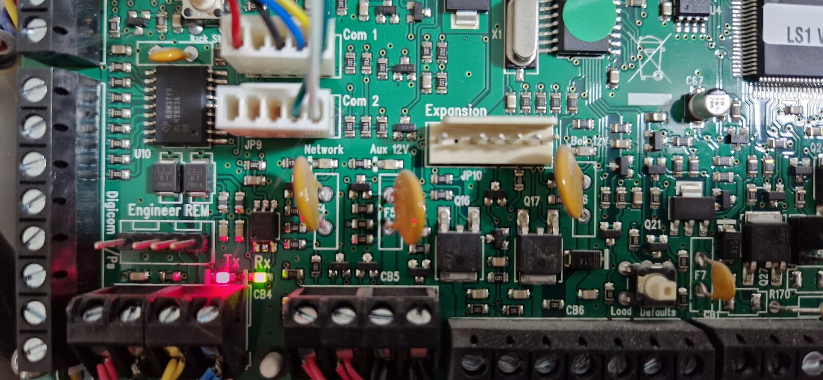

Hi,
I've done the dumb thing of taking one of my wired RKPs (there are 3, Premier LCDP) off the wall to paint. I got a tamper error that I fixed but returning to the RKP it was displaying random characters. Long story short, I have tried powering down, tried confirming devices etc. and now the display shows V10.100 Add=003 and the Rx led is flashing but I can't get any further. Any suggestions or solutions gratefully received.
That's one of the strange things - none of the cable connections was broken; just taken off the wall (mounting plate still on wall). I have disconected all 4 just to power down and check the connectons. I sure that nothing has been changed as I took a photo first (!)
I've checked the wiring on the other two RKPs and they all match. Are you able to point me in the direction of any other possible solutions? Thanks in advance
Go into engineering , eng utils , confirm devices , Power down the network ( pull network fuse ) wait 20 secs put fuse back in , confirm devices press yes , see what you have you should have keypad 123
According to the installation manual the network fuse (F4) is in the lower left area on the pcb but there are no fuses that I can see (or pull). Sorry to have to ask, but where is this fuse? Thanks
Followed steps but the RKP 3 is still only displaying V10.100 Add=003. In Confirm Devices the display is showing the following; Net 1, RKP > 123., EXP > 12.. Can the RKP be shot? Would it be simpler/easire to just swap it out for a wireless version? Thanks for your time
