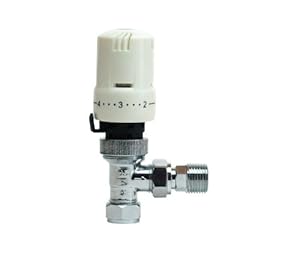

What I mean is the TRV is being "heated up" by the rad and so is shutting down before the room has reached temperature.. In other words the vertical bars of the rad are radiating in all directions including towards the TRV..
As for sizing according to the online calulators I need 6534BTU and this rad is 7952BTU so should be more than enough which is why I couln't work it out until now..
Basically I had the TRV on 5 (max) and I went to turn it down to see where it was cutting off (I can hear the water flowing).. As I turned it about 1mm it stopped completely.. So I removed the TRV head and the full flow went through and I could feel the heat coming off the rad increase.. So my conclusion is that the rad is heating the TRV and causing it to shut off..
What TRV are you using, some won't work properly when fitted vertically.
TRV is an "EPH Controls EN215".. At least thats what it says on the box.. Looks like this.. http://ecx.images-amazon.com/images/I/31iV5+ka0cL._SX300_.jpg[/QUOTE]
The TRV appears to have only one arrow on the body - pointing to the right.
If that is correct, the arrow must point in the direction of flow - towards the rad on the input (hotter pipe), away from rad on the return (cooler pipe).

I've had similar problems where the TRV is mounted vertically and the radiator is marginal.
Remote sensing TRV head is what you need.
If you have plenty of rad for the room this seems to be much less of an issue.
