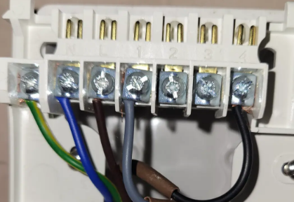

With the wiring as per the attached photo, the hot water heating doesn't work.
The central heating only runs if the hot water is selected to 'OFF'
I can’t help but notice you have tightened the screws onto the insulation, maybe try (humour me) just the terminal tabs onto the conductor.
I also take it that it worked ok, as in independently on the Horstmann?
Sorry, I don't understand what you want me yo do. Okay, I think I do - the insulation on the wires is what you mean

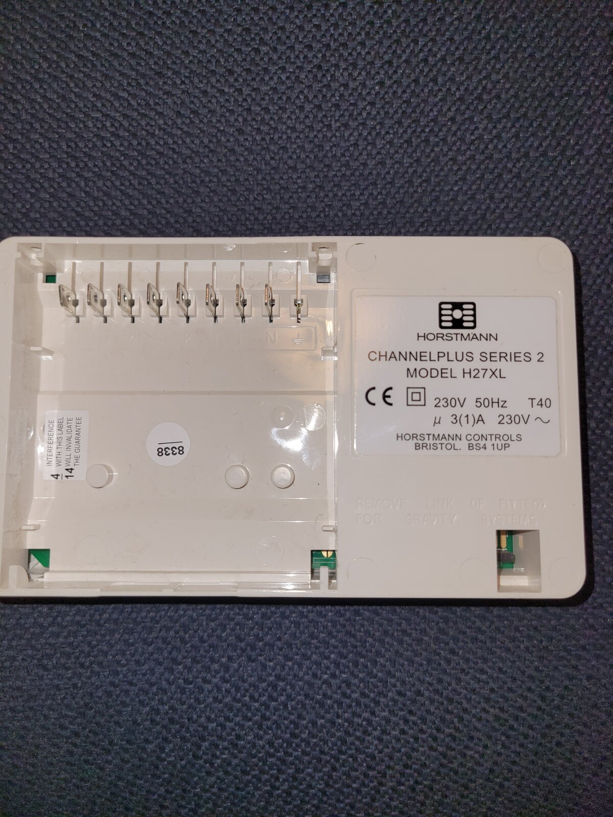

Usually it would work without a problem, but there was an intermittent fault with the Horstman - the central heating would work only when the hot water was turned 'ON' - The reason for changing the controller

The Horstmann had a specific setting to allow for a Gravity system; it would transparently switch the hot water on when there was a C/H call-for-heat.

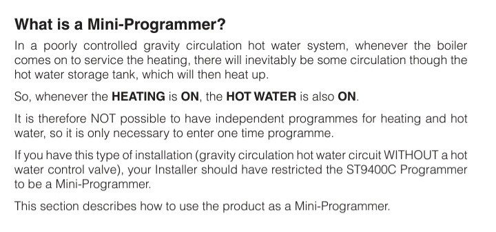

The ST9400C, doesn't have this - but it does have a 'Mini programmer" mode...
If you want to retain transparent operation, alternatives, such as a Hive, do have a gravity mode.
Or, for a gain in efficiency, it be worth looking to update your heating system with some valves?
In the mean time, if you wish to stick with the ST9400C, put the grey wire in terminal 3, the black wire in terminal 4 and put in a programme for hot water and one for heating to run concurrently, whenever you need C/H.

I've adjusted the wires so that the screws turn into the bare wire.
At the moment with the wiring as requested, the hot water works but the central heating doesn't work at all.

I was wondering why the C/H came on when the OP had wired Grey to the N/C terminal 1.
Power was provided to both grey and black, hence my thoughts on 'Gravity'.

I don't suppose the Grey and Black are the wrong way round are they?
That is:
Grey is Central Heating
and
Black is Hot Water.

I've changed them around as suggested.
The Central Heating works.
The Hot Water appears to work, (pipes are hot), but the pump doesn't come on as it did with the Horstmann
