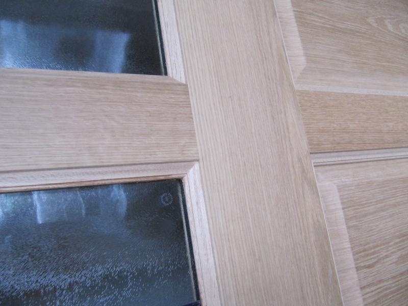

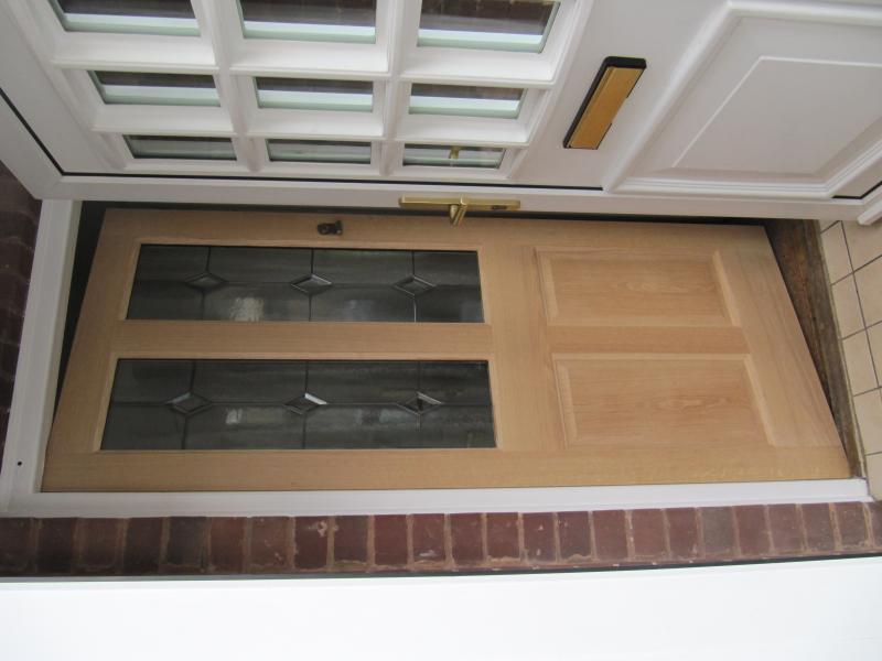

i have a new hardwood door on the inside of an existing porch.i would like to protect it for now.in the future i will stain it
but not sure what shade, and i wont be painting it.
can i use linseed oil either boiled or raw? or would you recommend something else
my mate in the rugby team is in the trade and he had his doubts, suggested i post on here and get a few second opinions. i will go with something water based, not the linseed oil
cheers guys
I wouldn't go for water based- it will raise the grain and you will need to sand the swell back. Then you will need to sand again after the second coat swells the bit that you just sanded...
Danish oil might be better or look at the sadolin range

Terence,
I can understand your confusion here, before further advice is offered do you know if the door was pre-treated, and if so with what.

The Dec asks a good question which is why I initially said "If it's bare wood, I'd just use water based (quick dry) clear satin varnish, because that pic looks a bit odd. I did several new hardwood doors in a flat last year and finished the lot in a day!! with a bit of antique pine in the clear water based satin to finish.
I'd not got the slightest problem with them rubbing down as it was easy. You'd be lucky to get that amount of doors done in a week if you'd use oil based varnish as the damn stuff does raise the grain and wont dry.
Incidentally Terence - don't use Solo, as it's not appropriate for this kind of work. :(
