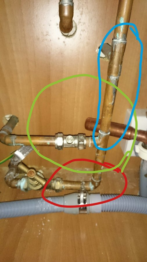

Just trying to work out the simplest way to fit my PRV under the sink.
Stop tap at the bottom in area circled red with no room straight after. Pipe heading left is just for the outside tap.
Aim was to reroute the pipes slightly in the area circled green so that PRV goes before the first tee, then raise the tee slightly and elbow off to the left then elbow down. But the combined length of the PRV and new tee joint would overlap the next tee up.
Is it OK if I put the PRV after the first tee that heads to the outside tap only? Then I have slightly more room in the blue area with a reroute of the tee moving it up slightly
Any more simpler suggestions at all would be appreciated :)

Easy, just put it in the area where blue and green intersect!

Thanks Tony, that was my plan but the length of the PRV will only just about fit, so isn't then enough room for the new tee. Unless I'm missing something?
