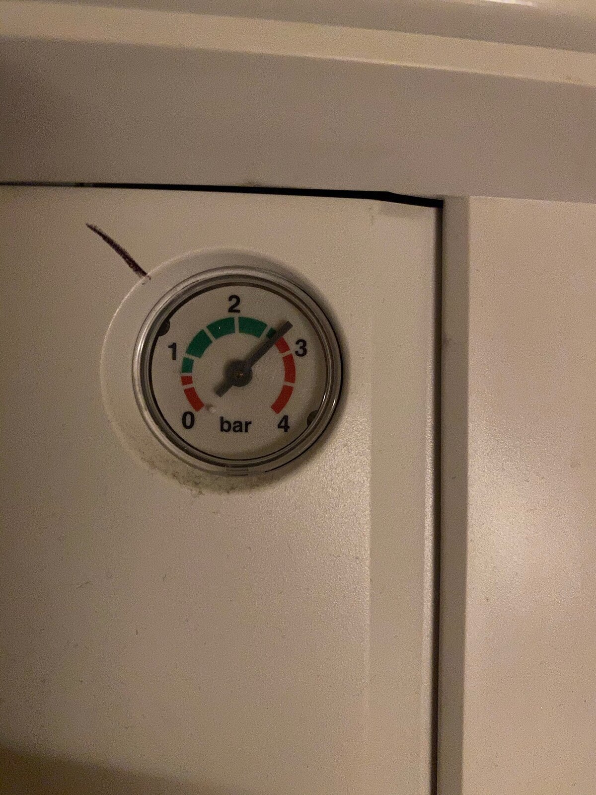

Putting sealant into a boiler
This is what pressure is on now after all heaters on for an hour, but when I get up for work in morning it will be down on 0.

As others have said ,your expansion vessel needs attention. If you only top your boiler up to just under 1 bar, when it's cold, what does it then rise to when heating has been on for an hour.

As you are selling the flat, selling it with a known issue may have some implications, you will also need to provide a gas safety cert as part of the sale, so will have to have a service at some point, and it's likely the fault will be picked up then.
So at some point you will have to pay for a fix. As has been stated it sounds like an expansion vessel failure, it's not usually an expensive job.
You have an expansion problem, get it sorted sooner rather than later , you are damaging your boiler from the inside
Going by your picture it's hitting 3 bar. As said looks like vessel needs topping up.
If you've got steel rads and keep filling up with fresh water every day you're going to end up with far worse problems.

The point being made, and also having seen the pressure on your picture, is that you're more than likely losing water via the pressure relief valve because your expansion vessel is not pumped. So adding leak sealant will be of no use.
Also if you do want to add it then you'd need to know some basic plumbing skills anyway. Isolate a radiator, partially drain it by loosening a valve and pour it into that after removing one of the top vents.

The starting point for diagnosing a pressurised system loosing pressure, is always one of checking the PRV and EV. It's not maybe what you wanted to hear, but none the less it is the correct place to start, rather than assuming a major leak, or adding sealant.
Adding sealant is at best a botch, which might obstruct the narrow passages in your boiler, turning a minor problem into a major one. Your other suggestion is one of topping it up daily, to keep it working - this dilutes the inhibiter which itself carries the risk of rotting your radiators out from the inside. So then you (or whoever buys your place) end up replacing leaking radiators, suffering pipes choked up with debris and the boilers water passages too.
By far the cheaper option is to fix the leak properly, starting with the PRV and the EV, to see if they are the problem - as seems most likely now and leak sealant will not help with either of those.
