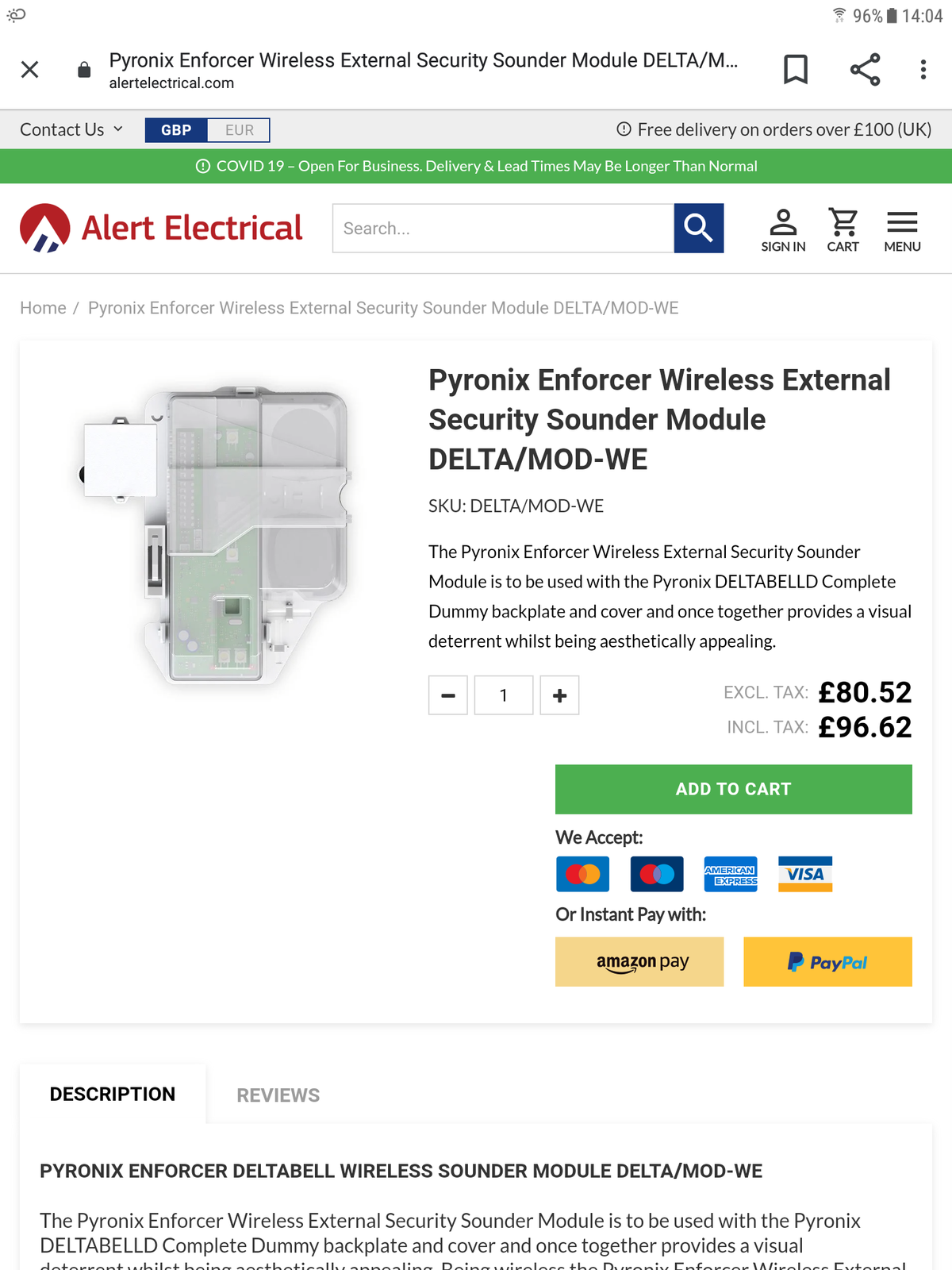

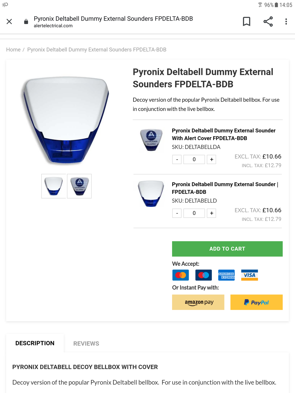

You will need to purchase a Pyronix wireless bell module and a dummy cover and back plate to make up the complete bell box.
Go into programming wireless devices,wireless bell and learn bell box on to your existing system.

Thanks very much for that, that makes much more sense.
It's a lot more expensive than I thought it was going to be though :ROFLMAO:.

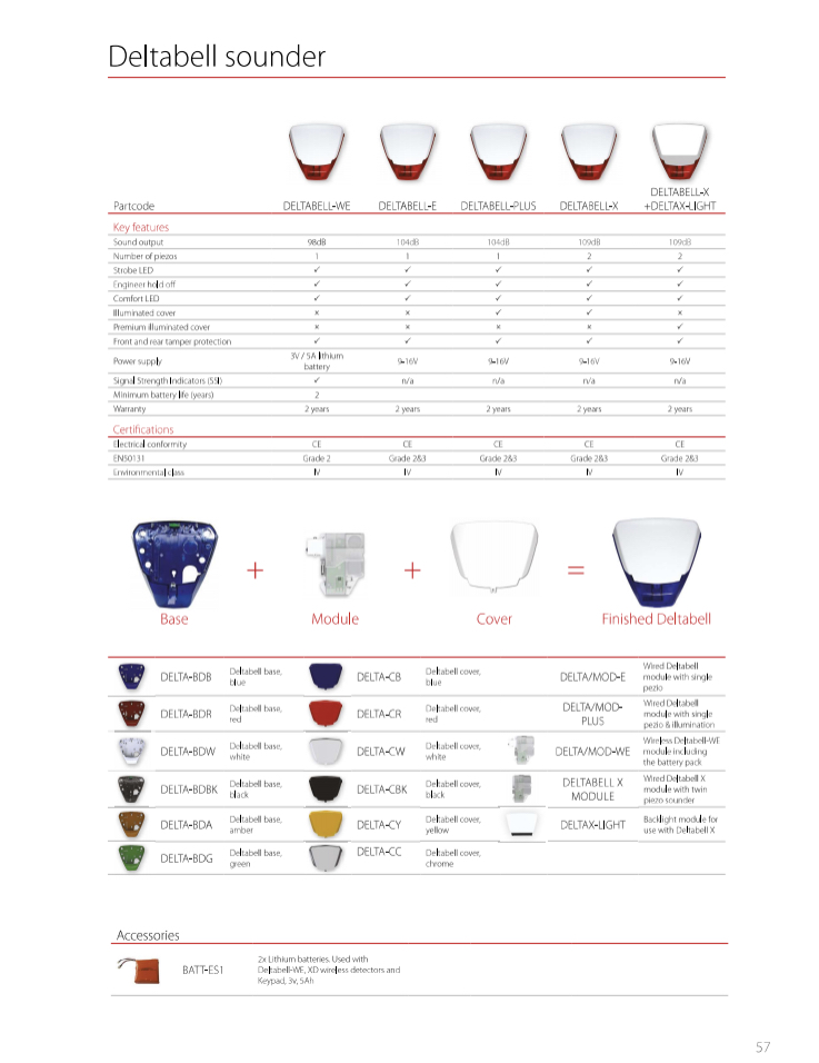

Not a stupid question at all. Why Pyronix have so many different versions of the Deltabell I don’t know. Then you have to assemble it as a kit o_O
That's because they have standized on a common back plate and cover to suit you requirements in the grading or your system. Different module's fits all.
:confused:
As I understand it all the models can be either either grade 2 or 3.
No
You need to purchase a grade 2 version or a grade 3 version.
You could use a grade 3 version as a grade 2,but not the other way round ,this is due to the fault outputs on the grade 3 version,
No
Not according to this
