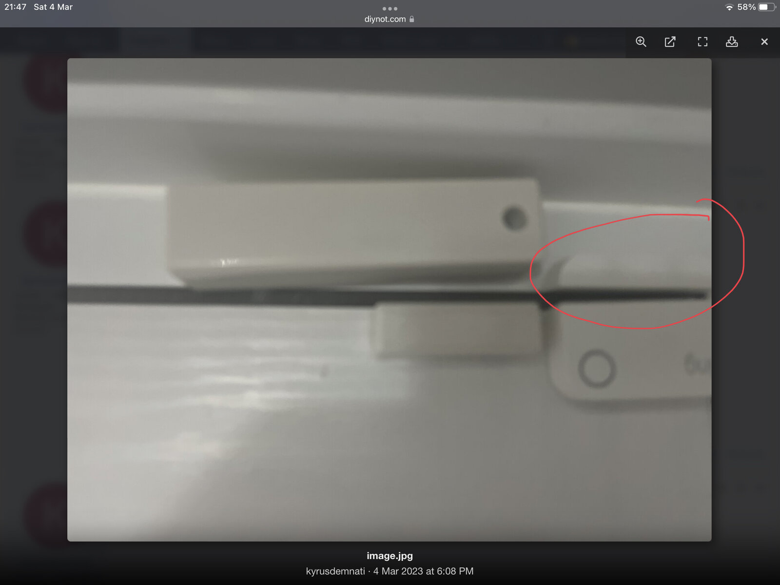

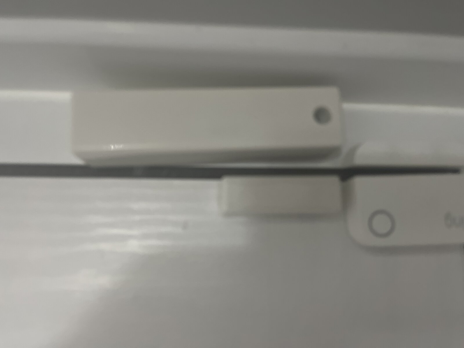

Is it new ? Does the light come on the sensor when you open the door ? ( better to see if it’s dark )
Ignore the ring one.
The light doesn't come on when door is open
I know I should see a blue light
When I remove the screw
The system does recognise a tamper and alarm goes off ,
I've unpaired it for now, as I get a test failed error when saving nvm data
And I don't want the alarm to randomly go off
What that at the side of the enforcer MC1 ? looks like another wireless device with the magnet near the Reed switch of the MC1
It’s easy enough to test, remove the ring magnet that’s on the frame.
Then retest.
Ah you are right . I see the blue light come on immediately when I open door
