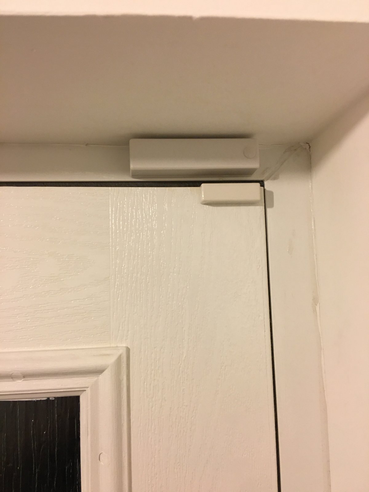

I think it’s mc 1

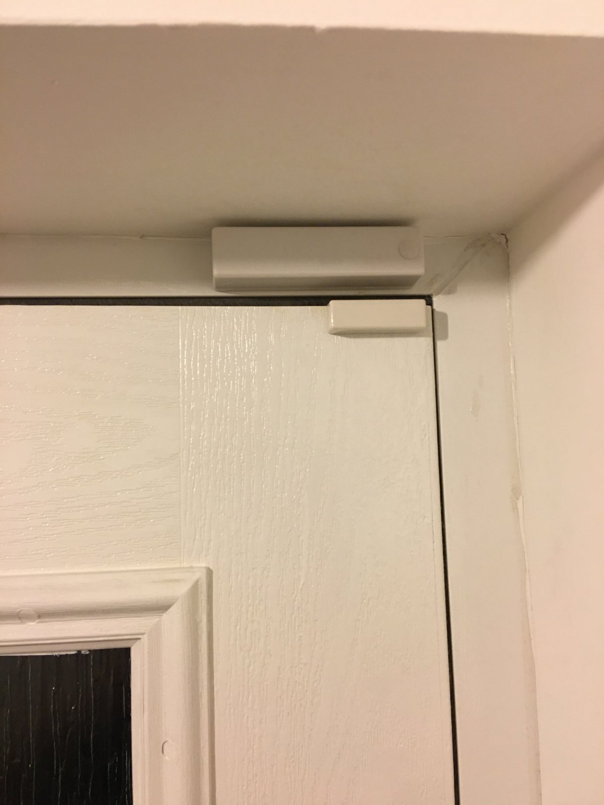

Hi
Are these any good

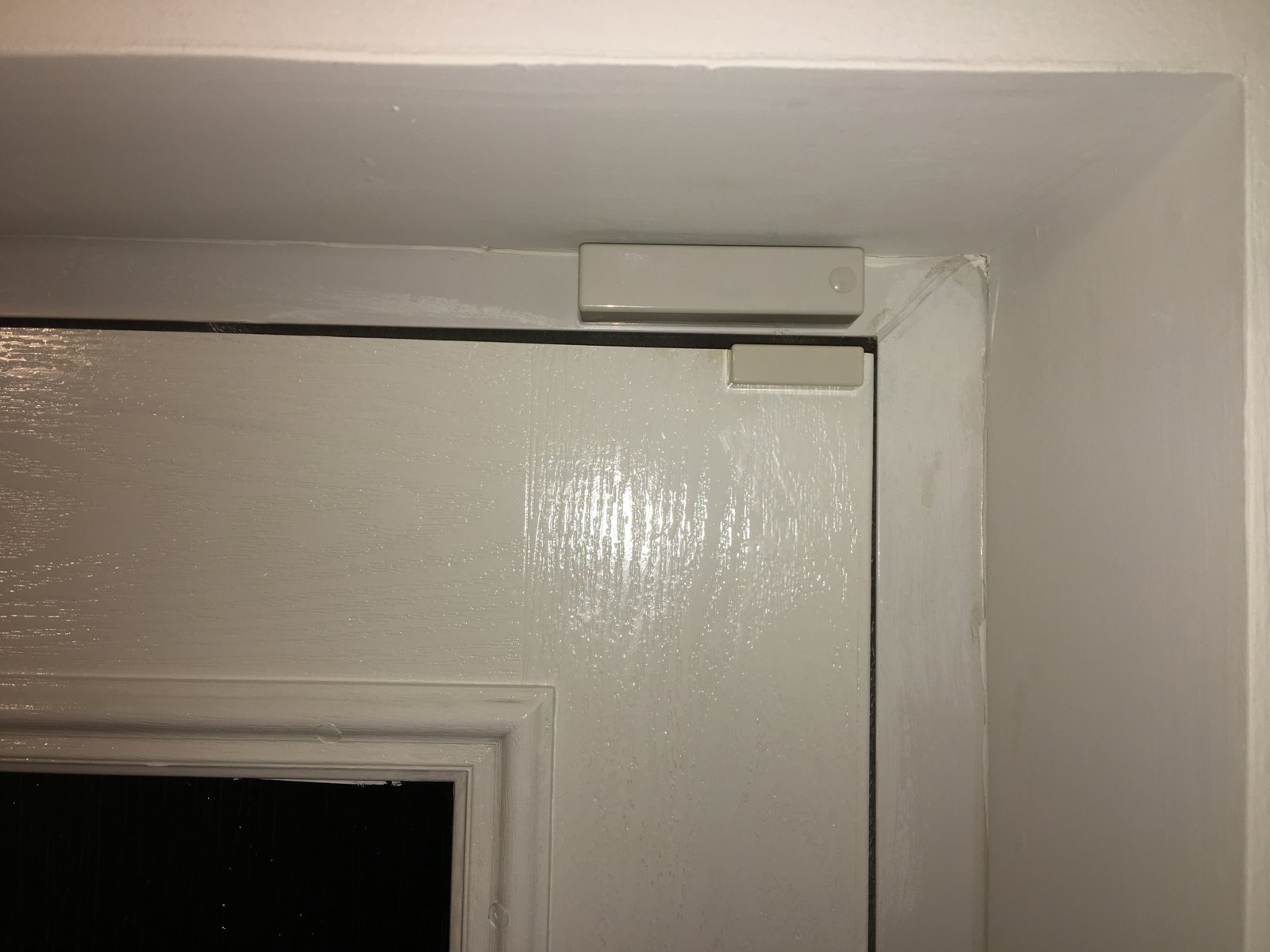

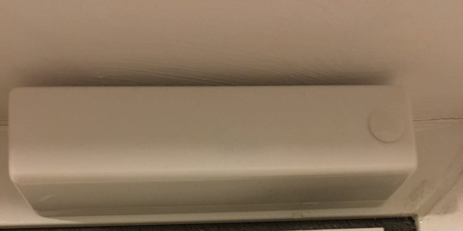

That’s better
Are you sure that it’s set as 07 final exit ? And what is area A set as in setting type ?
