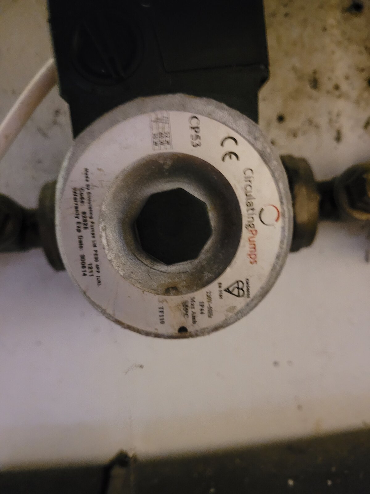

No it's pretty cold. This is out beside the boiler maybe it's not working
