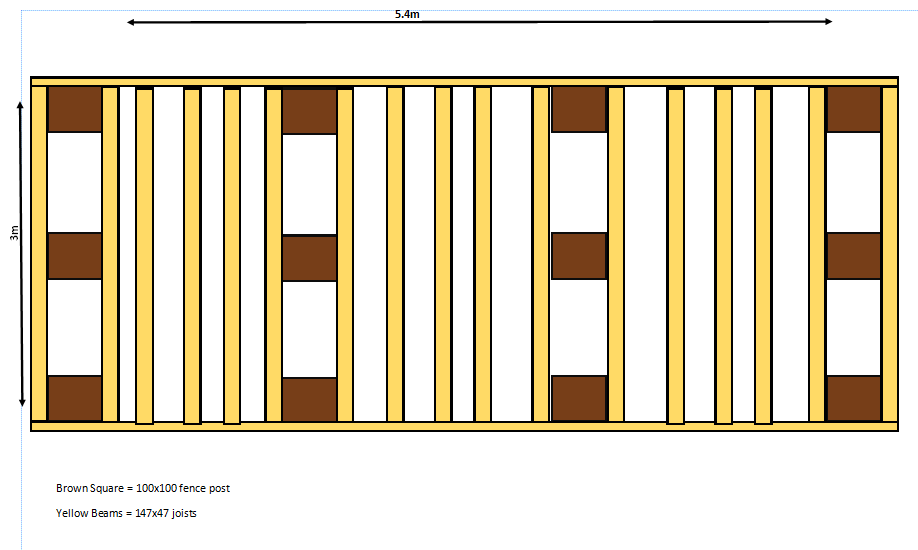

I am looking to start my own deck project but after watching a lot of YouTube videos and reading a number of tutorials I am questioning my own design (rough Sketch on Publisher and not drawn to any sort of scale!)
I am seeking on advise as to whether I am over/under engineering my deck which will be raised by approx. 300mm
Here’s the breakdown.
- 600mm deep holes for the 100x100 fence posts which will sit on split breeze blocks, post creted in.
- Joists attached to the fence posts with coach bolts and washers driving through both joists where necessary.
- Joists attached to the outer “joists” with coach screws (where they cant be attached to a post) at 400mm apart.
So I guess my following questions are;
- Is this fit for purpose as a base?
- Do these joists which aren’t supported by posts need hangers?
- Do I need noggings?
- Or is it terrible, bin the idea and hire a professional?
Appreciate any assistance.
Thanks,
There is a million ways to build a deck and this looks like a solid design to me. She is going nowhere.
600 deep holes for posts might be overkill on the excavations given you are only raising 300mm but if you enjoy digging holes go for it. 400-500 fine too.
yeh def need noggins down the middle will keep all your joists from twisting in the middle.
no need for hangers unless you are planning on letting your pet elephant jump up and down on your deck.
Worth spending extra cash on composite deck boards in my opinion unless you want to treat it every spring.
No need for a ‘professional’ - you can do it!
just make sure you keep below 300mm at the highest ground level to avoid the need for planning
also the 50% rule iff a small garden

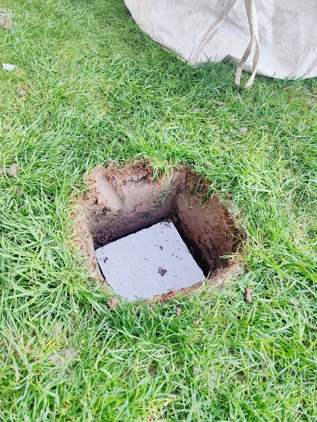

I've done a 300mm hole with a split breeze block leaving 200mm for concrete. Is that enough for the inner posts?
Main thing is you should have got down to the subsoil and it should be solid and square, and 150mm of concrete in the bottom to build off
