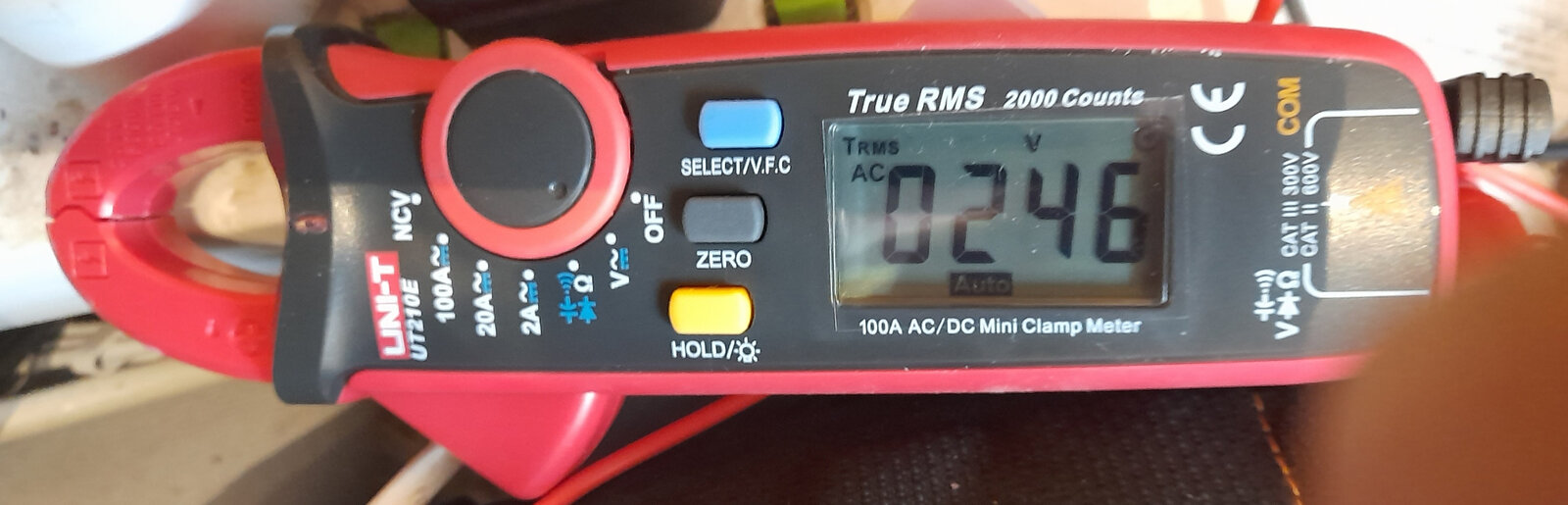

Until late last year I could not measure earth leakage, my meter went down to 0.01 amps, so any reading would be a fail, and in real terms no help working out if on the edge, or loads of lee way.
Now I can measure 0.001 amps, I can see back ground leakage, and know how close to the wind I am sailing.
The insulation tester will show one DC leakage, but we use AC, so we have capacitive and inductive linking, so still a useful tool as can be used power off, but it does not show how close we are sailing.
With no meter the only option is to split into as many circuits as one can, without a re-wire, using all RCBO's, with the meter one can see what the leakage is, and do a risk of tripping assessment. They are not that expensive both my clamp-on and insulation tester were around £35, but £70 is still a lot of money for some thing which does not make it any better, but just lets you see how bad it is.
My meters VC60B.jpgTesting voltage.jpg are not celebrated, and not what a professional would likely use, to get them made by AVO, Fluke, Robin etc would cost a lot more, but good enough for what I want, and I find the non contact amps and volts very handy.
