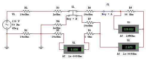

I will try to draw a diagram and post it to explain.
OK I have a program called Multisim which allows me to simulate all sorts of electrical and electronic circuits and I have used this to simulate the supply to a house with a fault.
This first one shows a large load and I have given the wires a resistance the resistance on line side really will make little difference but on the neutral and earth side after the second earth point the values will make a big difference to the result.
The U1 ammeter shows the leakage current. The U2 ammeter shows the current used and the U3 voltmeter shows the voltage at the load (R9) the fault is shown as R8 at 2 ohm all other resistors in milli-ohm.
In the second picture the only change is size of appliance and here we are just on the limit. The third
shows it with still smaller load and under limit.
the 4th one shows the same load on faulty circuit as 3 but has a second circuit with high load and you will note the milliamps leakage has increased showing that it may not be the item which is switched on when the earth leakage trip opens which is at fault and also how an item not even connected to the RCD can initiate the trip.
