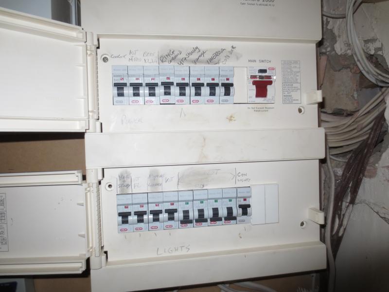

Do you have a dual or single RCD board? Perhaps you can post a picture of it here?
//media.diynot.com/134000_133220_75356_64903551_thumb.jpg
It's a Memera 2000

He did upload the pic to his album:
Aragorn, it doesnt display in your post. Lets see…..
Aah, that's better.
The basic problem is that the entire installation has just one RCD as the main switch. This is poor design because (as you have found out) one fault kills your entire house. It's a common sight, unfortunately.
