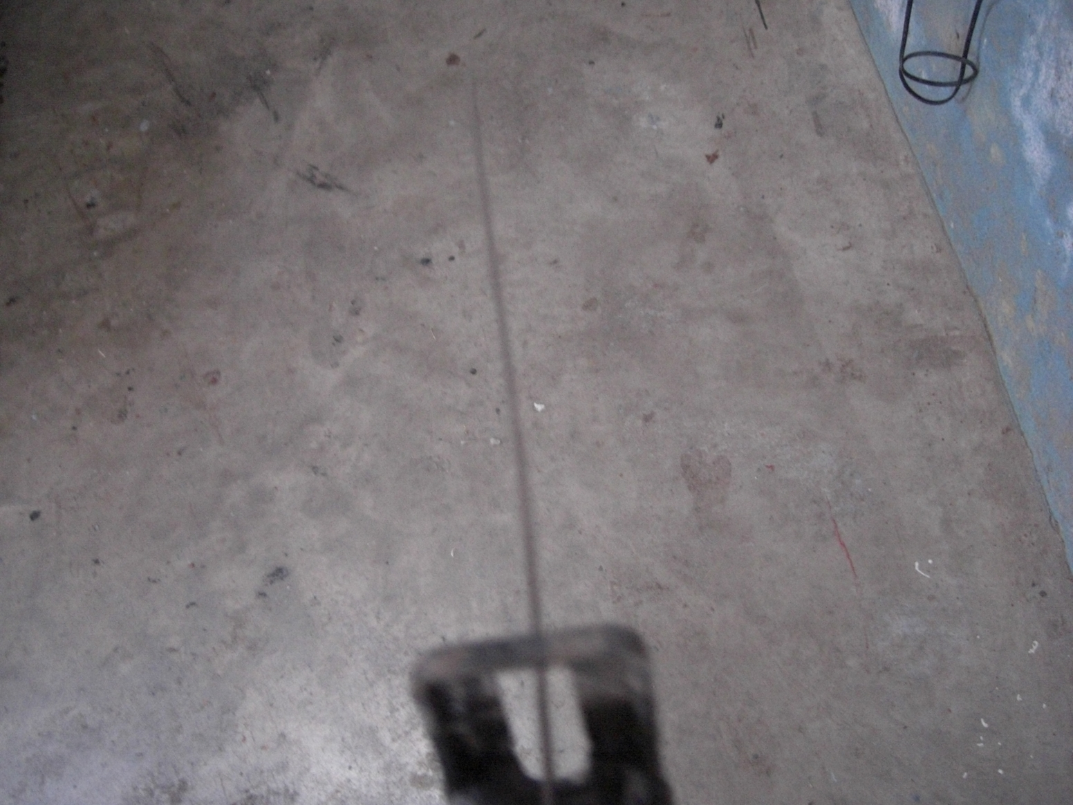

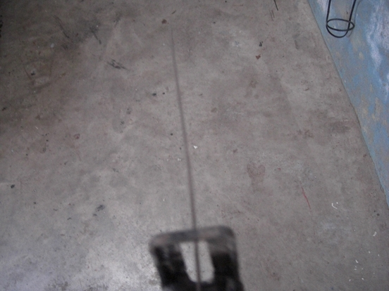

Hi,
I've just bought a Titan reciprocating saw and some blades for cutting metal.
I've just tried it out and there is very significant flex in the metal cutting blades. Below is a picture of the saw running with the blue blade that came with the saw and the white metal blade.
The saw is not variable speed, and the flex begins almost immediately after the saw starts running.
Is this normal? If not, is it a fault with the blade, or the saw? Is it safe to use?
Any thought would be much appreciated.
Expect some flex because the blade is only supported at one end.
It might be worth trying the white blade on wood.
I assume it's correctly fitted into the holder
Blup
Firstly, cheaper blades are thinner than reasonable quality ones and will oscillate more. Bosch, Milwaukee and deWalt are all good brands but cost more. Secondly, you need to use the shortest possible/available blade for the job in hand - using a 300mm demolition blade, even a good one, to cut down 12mm plywood will result in oscillation whereas using a 120mm short blade will be much better and oscillate less. Thirdly, recip. saws should be started with the blade on or just above the material and the foot adjusted so that it is resting against the "end" of the material - in use they do oscillate much less thsn if you hold them up in the air and switch them on. One thing - these saws absolutely must be use with a two-handed grip in order to exert the maximum control and the workpiece should be adequately secured/fixed-down. Goggles are advisable. too
Perfectly normal. There are ways to keep the cut straight regardless depending on material.
Thanks for all the input. Used it to cut up an old aluminium frame today. Seemed to work OK, although the blade took a far bit of damage.
