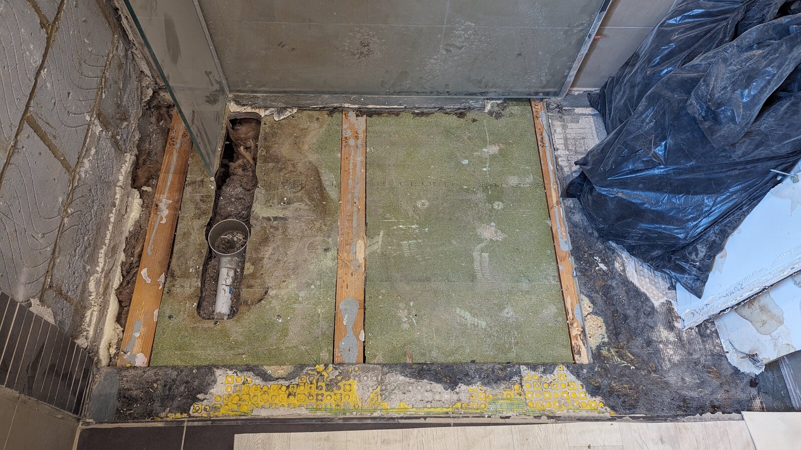

Not seen a recent thread on this so hope someone can help.

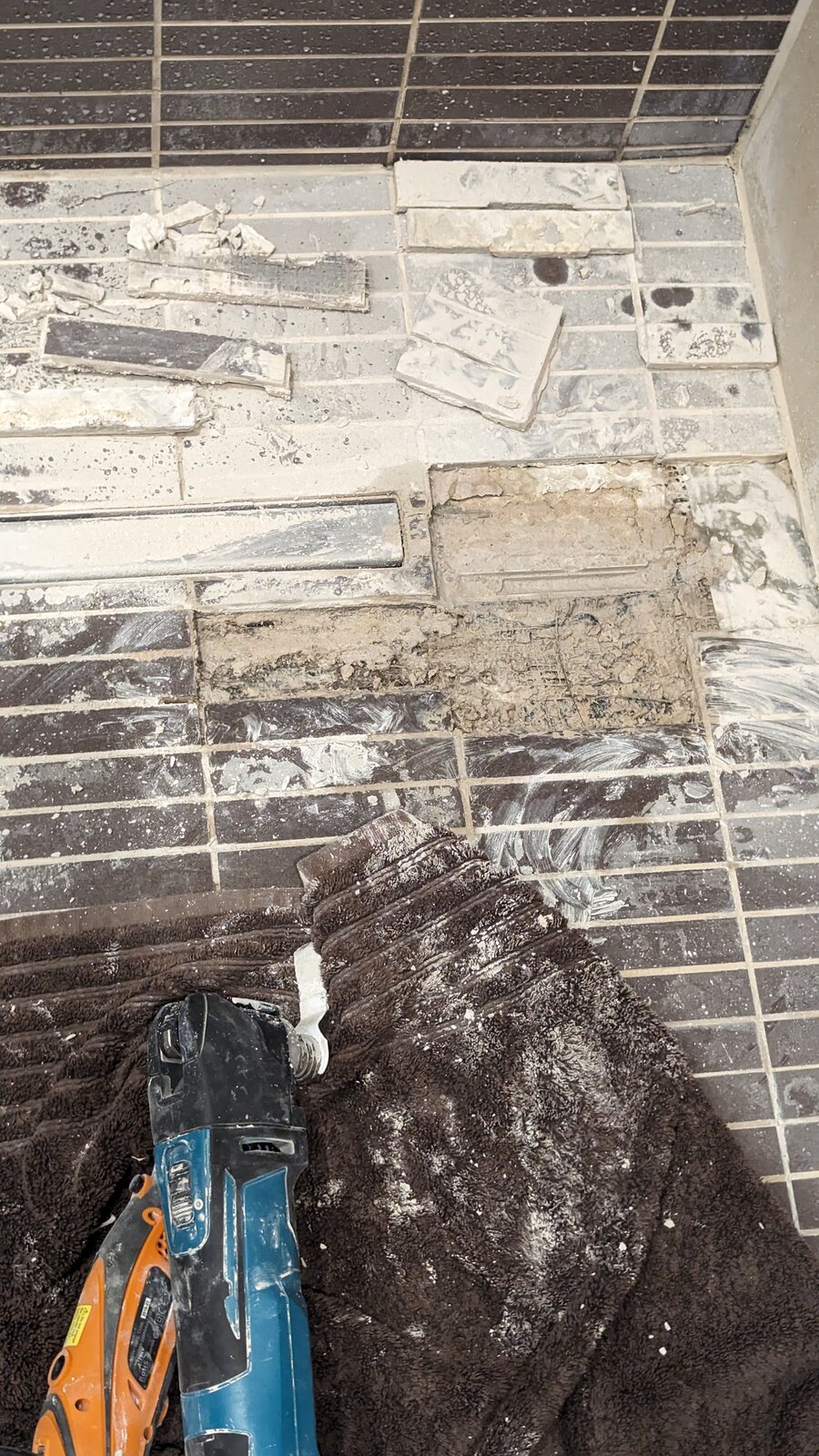

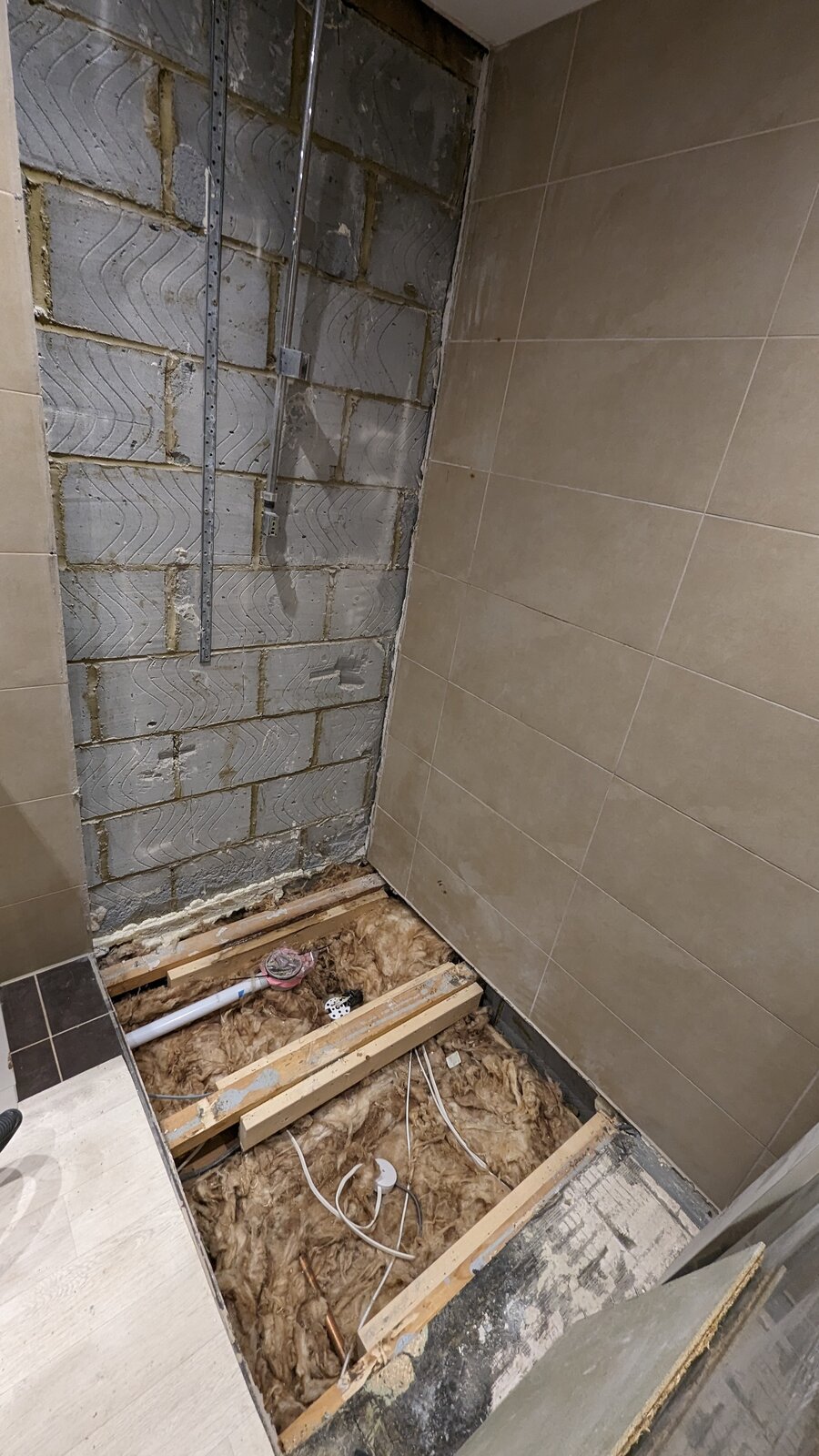

Since being in this house we have always had issues with the mosaic tiles on the floor that needed regrouting once a year. We went away in December and come back to them being 'bouncy' and I said enough was enough and starting ripping it out. It's taken some time to extract the existing tray without causing too much damage and have got to a point where I just need to replace board on one wall, sort out the floor and put a 'normal shower tray' in (doesn't need to be flush).
Originally I was planning an Ideal Standard Ultraflat S and then was considering Mira until I saw a video recently on YouTube about bad finishing/moulding around the waste.
After some searching come up with Matki, Merlyn, Crosswater and Kudos as decent trays. Would really appreciate input on a bullet proof tray and how to do it (given that I don't intend to take down the other walls).
Am totally happy to part cover the tiles with plastic panelling. Any help would be much appreciated.
