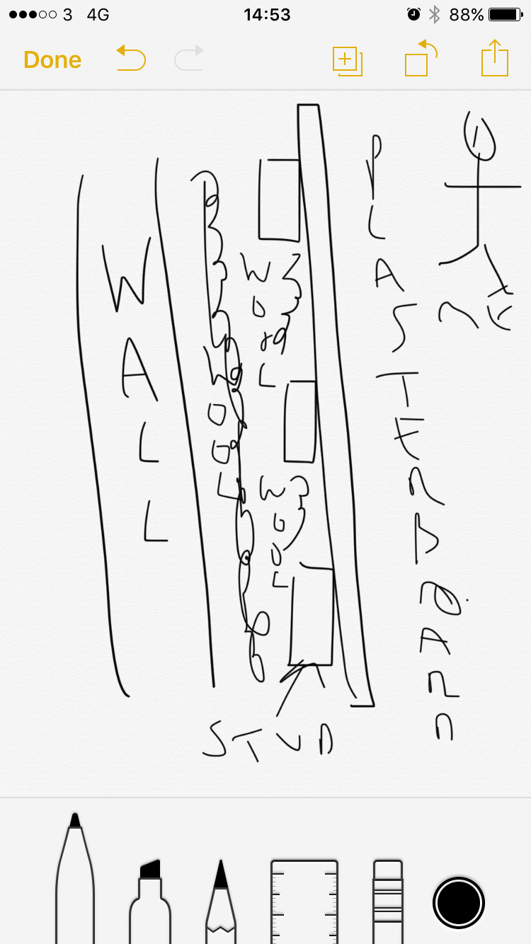

Reducing sound through party wall in loft conversion?
Ok cheers, i've knocked up a diagram in AutoCAD:
I used a very similar approach to that shown in your highly detailed technical drawing :D

I lined the whole party wall with 30mm high density rockwool slabs, held in place by adhesive and insulation fixings. I left a small air gap for isolation then built a stud wall with minimum contact points to the fabric of the house (none to the party wall itself). The space between the studs was filled with regular rockwool bats, then covered with 2 layers of plasterboard, with staggered joints, sealing any joints, gaps or edges thoroughly on both layers.
Sure we lost a good few inches of living space and I had to narrow a couple of doorways, but the reduction in sound transfer was dramatic. From sounding like they were in the room with us to a point where we could barely hear anything, only the slamming of doors.

The sections I need to do are 3 x odd shaped triangles.
For fixing should I fix to my last rafter, to the floor, and one into the chimney breast? Like this with the white bits being screws:
