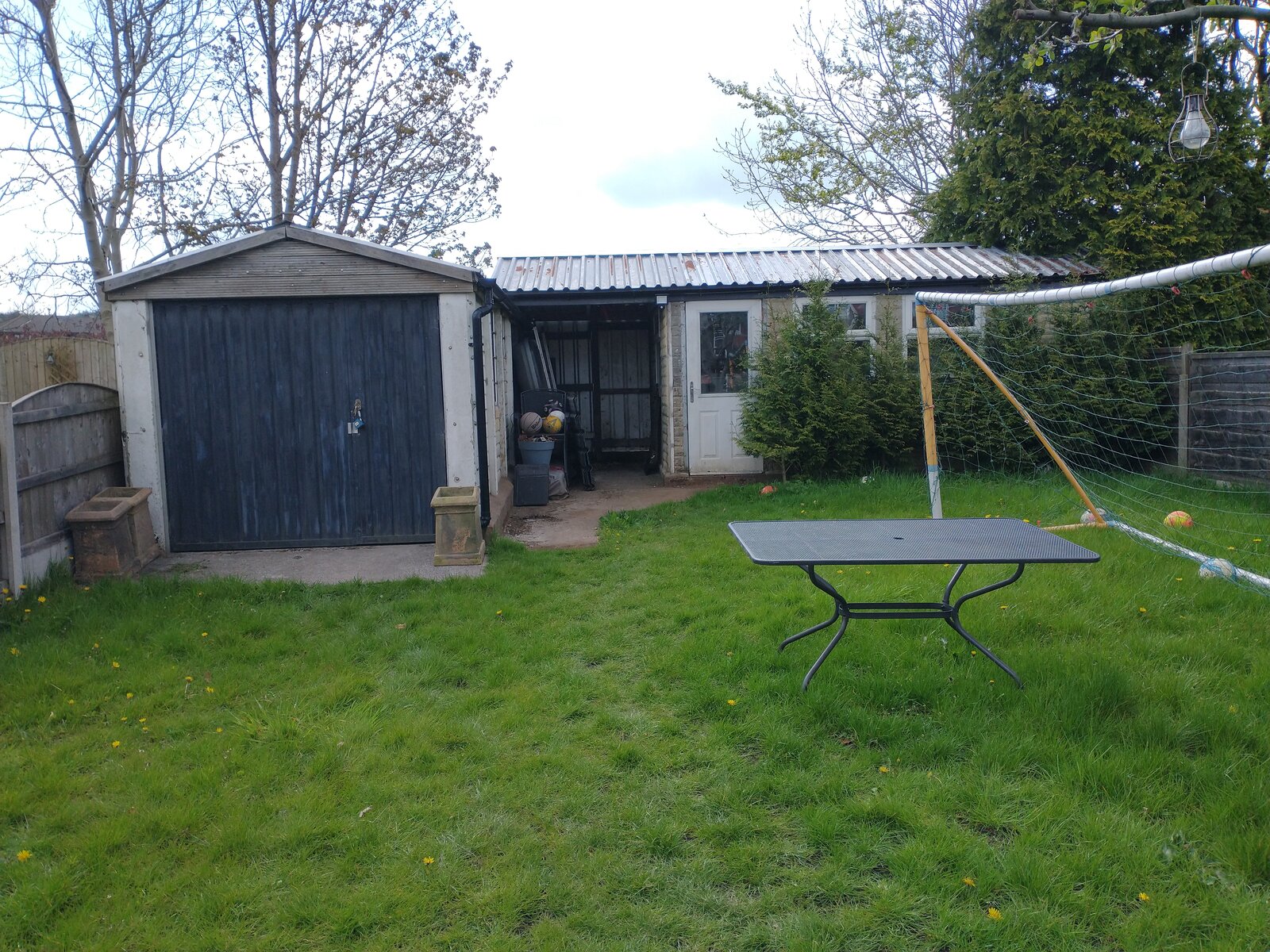

Has anyone gone through building regs regularisation? I understood that this is how you can retrospectively achieve building regs.
I have converted a detached garage into a habitable space and am contemplating going through this.
I’d appreciate any insight you can share on this.
Thanks in advance
The problem is proof of how it's built.
It's likely establishing the construction methods, materials used etc would require invasive stripping of the various elements.
Do you believe it is compliant?
It's all down to the inspector. Some want an easy life, some what to give you a hard life.
If it looks like it's been done properly then the inspector takes it that it has, but fire safety tends to be the main thing to watch for.
Is it actually habitable space? I think there are many things you can do to a detached garage without tripping over the line. Hobby rooms, art studios etc I think would all be OK. If there's a bathroom and bedroom not!

Almost certainly not. I recall the builder using battens and some loft insulation before it was boarded up. I am prepared to reinsulate this if that's what they recommend. It's an acceptable price to have this formalised.
My main concern is whether the inspector will just focus on the above or is he/she going to be asking questions about how and why I have been using it for and whether I should have planning permission, etc.
What are the personal ramifications to you and your brother if you do absolutely nothing- what is worrying you most? I ask because this has gone on for years without problems; planners have said they are not interested; and no-one (I think) has complained. There seems to be 2 issues: council tax liability and BR compliance. You COULD, just do nothing unless and until you need to.

Just remember the old saying - it is easier to ask for forgiveness than permission. If you apply for regularisation and its denied youre hosed. If you do nothing then eventually the enforcement time limit kicks in.
I am in the process of turning my detached garage into a granny annex , firstly I had to have planning permission for a change of use. it will have a stipulation that only immediate family can live there. also you will have to use the services from the main dwelling.
then there are the current building regs. electrical cert, insulation required, suspended timber floor 100mm cellotex, walls 60 mm dot and dabbed cellotex, ceilings 100 mm between joists crossed with 60 mm of thermoboard, heating source, doors and windows argon filled, trickle vents .
smoke and heat alarms etc.
there will Never be a time when you can legally rent this property out. the person who lives there will be down on the main house electoral register.
I also think that the roof would not comply to habitable building control standards.
The roof covering would be fine, the insulation would have to be a minimum standard.
