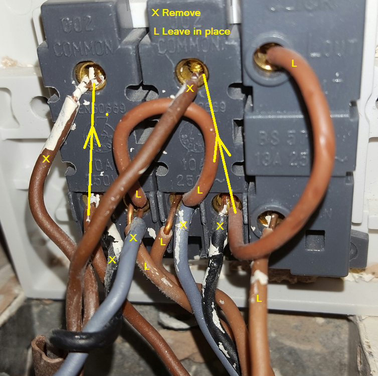

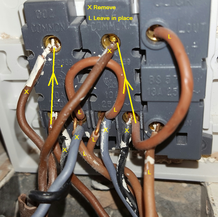

Removing 2 way light switch
@JohnW2
Can you please kindly confirm I understood you correctly?:
@EFLImpudence
By following your Diagram the switch I want remove will no longer have any connections as I am disconnecting all 6 wires going to it, correct?
Many thanks.
No you must put the L2 wires in separate blocks. That is 4 blocks in all.
Yes correct. It will be completely disconnected.
@JohnW2 Can you please kindly confirm I understood you correctly?:
NO, that is not correct - your lights and fan would both be on permanently if you did that (regardless of the other switch). (what you seem to have missed is that the 'top' and 'bottom' terminals in your picture are electrically connected). If you wait a few minutes, I will illustrate what I meant.
Kind Regards, John
Here you go ....
As I said, swap L1 and L2 if the other switch works 'upside down. You can either have two separate 2-way connector blocks, as I have shown, or else one 4-way strip - but all 4 connections should be to the same side.
Kind Regards, John

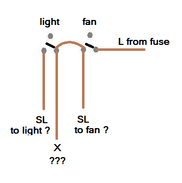

Without the strappers,
this is what's left.
Treating the switches as one way now,
I do not understand the arrangement.
Were the light and fan the other way round then the fan would only work when the light was on, or be permanently off.
Understandable and acceptable.
As it is, the light won't work unless the fan is on - obviously undesirable.
What is wire X?
It could be line for light, but fan would be permanently on.
It could be permanent line to fan, but would render a timer inoperable.
I might expect liszega to come back and say "oops, no, the light switch is next to fuse" but other than that it doesn't make sense.
Any other ideas?
this is what's left. .....Treating the switches as one way now,
I do not understand the arrangement. Were the light and fan the other way round then the fan would only work when the light was on, or be permanently off. Understandable and acceptable. .... As it is, the light won't work unless the fan is on - obviously undesirable.
Quite so.
Any other ideas?
I'm not convinced that it would necessarily make things much more understandable, but is it not possible that your "Wire X" is the permanent L feed and that the fuse is in the feed to the fan? (although that would probably only make any sense if it were a non-timer fan).
liszega: is yours a 'timer' fan - i.e. does it carry on running for a period after it and/or the light is turned off? ... and can you perhaps have another go at explaining how the switches work. In particular, can the fan be turned on (and off) with the fan switch regardless of the positions of the two light switches (all four possible combinations)?
Kind Regards, John
