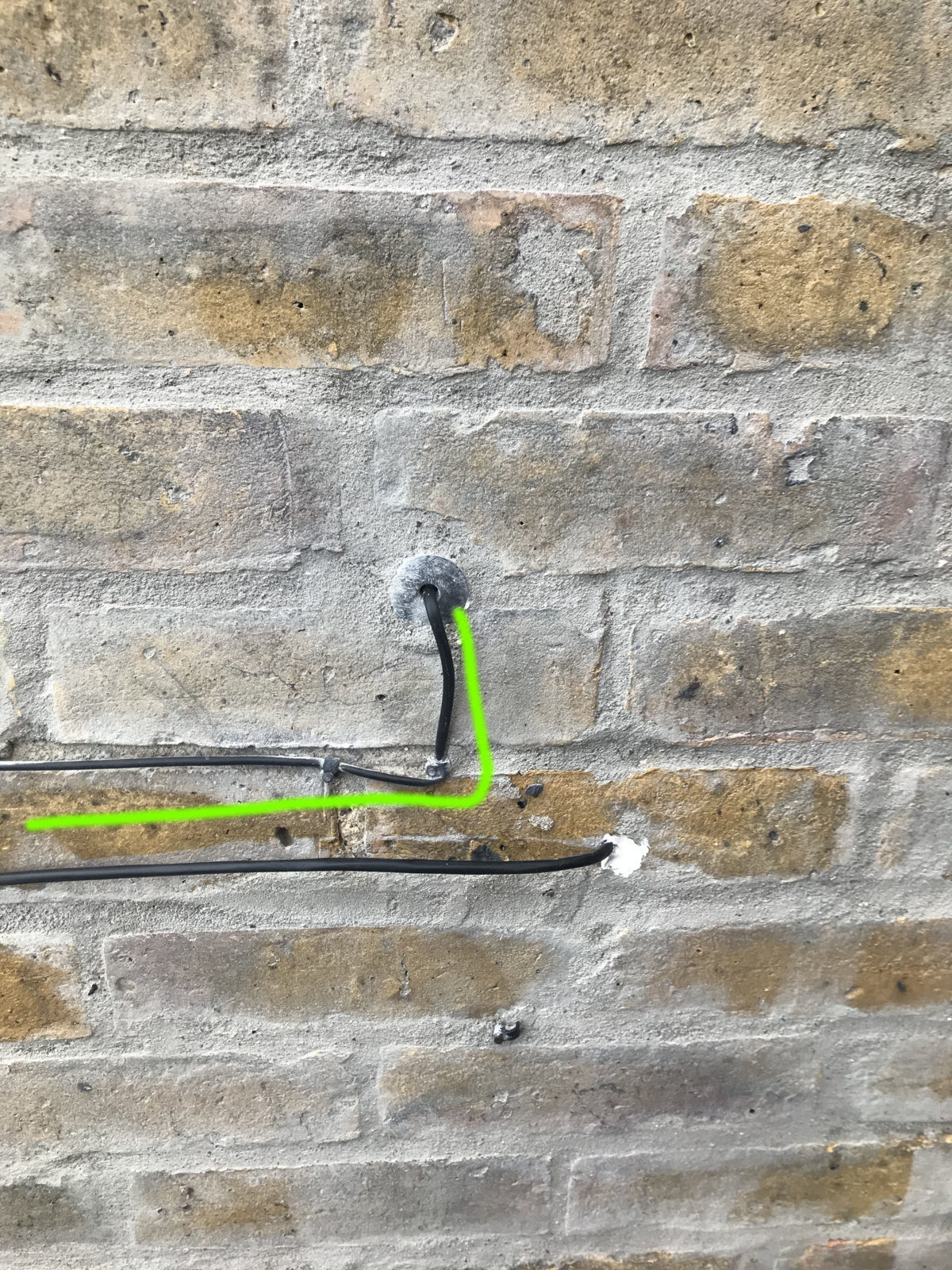

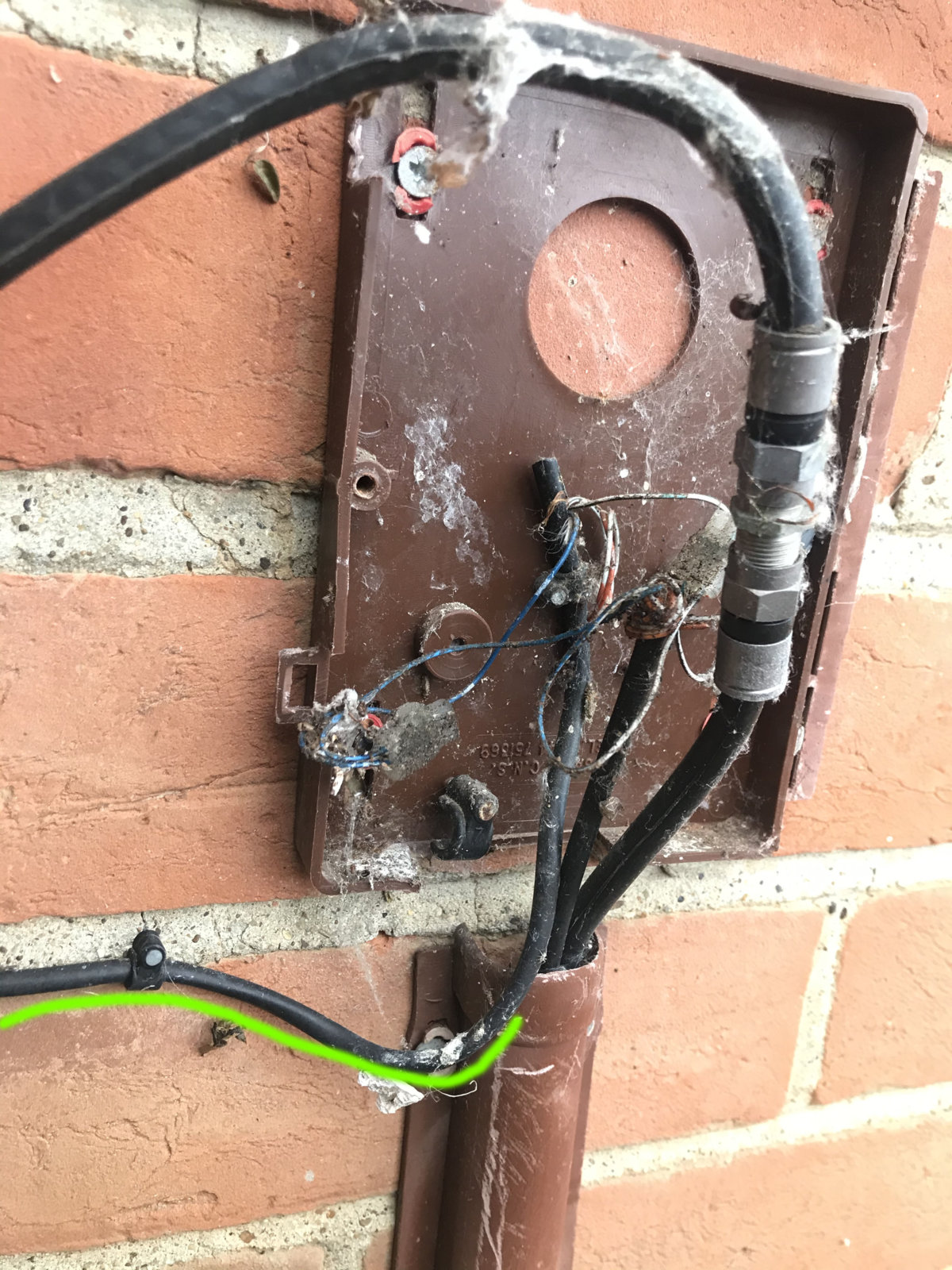

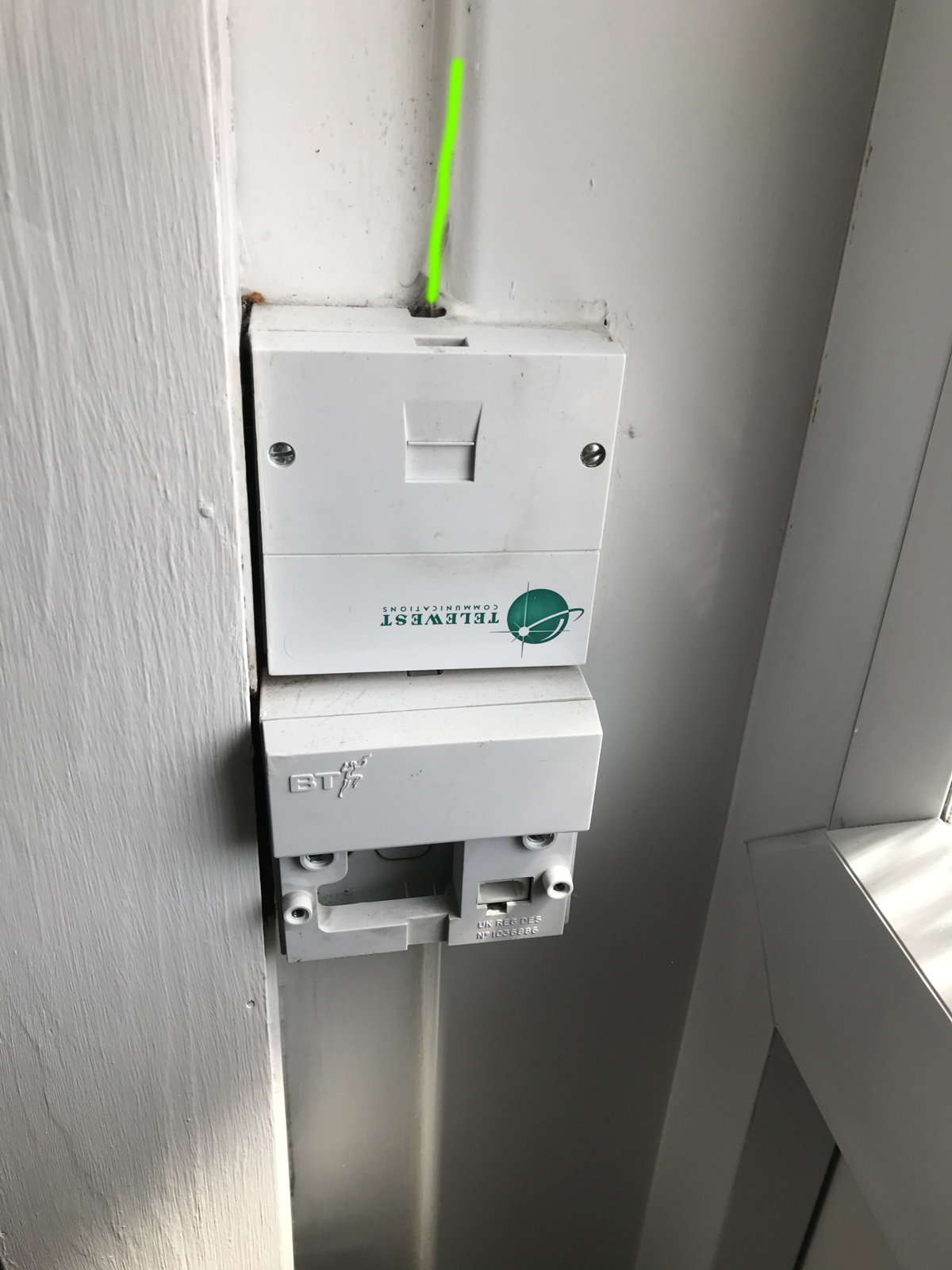

I have an old Telewest socket (phone line I believe?) that I would like to remove prior to redecoration. Some assumptions:
* We have no use for this whatsoever, and never will.
* Socket was already in the house prior to us moving in, never been used.
* We are Virgin clients but only for Broadband. Even if we wanted a phone, you can just connect the phone directly into the Virgin hub/router.
* Virgin want £99 to come around and disconnect this!
I have attached 3 pictures demonstrating the socket, the outside wall and the old telewest box where the phoneline and broadband connect to, I have also highlighted the cable in green.
Ideally, I would like to get rid of this cable myself - I can see it connects to another cable coming from the ground, with limited electrics knowledge - what can I do here? Simply cut the cables? Is this something I should be doing myself or just bite the £99 bullet?

If it were me, I would disconnect and pull back to the outside, leaving the cable coiled up in a small external waterproof box.

Cut the cable in the external junction box and remove the rest. I have done this for customers plenty of times. Like you said, VM are moving to VoIP based services anyway.

Decorative purposes, we are having some work done and would like to replaster. The BT one I am happy to pay to have it relocated (it is the master socket), but the telewest one is just a nuisance and remnant of older days.

Just remove them both and forget about it. Neither sockets are in use. I should imagine the BT one will not be live if it hasn't been used for years (the pairs have probably been long reused to service other customers)
The VM one will never be reused as they are moving to VoIP.
If you ever got a BT line put back in they'd send an engineer anyway to reconnect it back to the exchange. (the stop sale for copper is within the next few years so it will probably never be reused)

Speaking about the telewest line exclusively, would I just remove the socket and leave the cable behind any new plaster I put up? Could I also remove the cable altogether? It runs across my house and doesn't look all that great.
I'd remove it all the way back to the external junction box. Especially if it'll improve the aesthetic of the house
Cut the cable inside the junction box so you can make it look tidy. Just don't cut the coax only the phone line.
