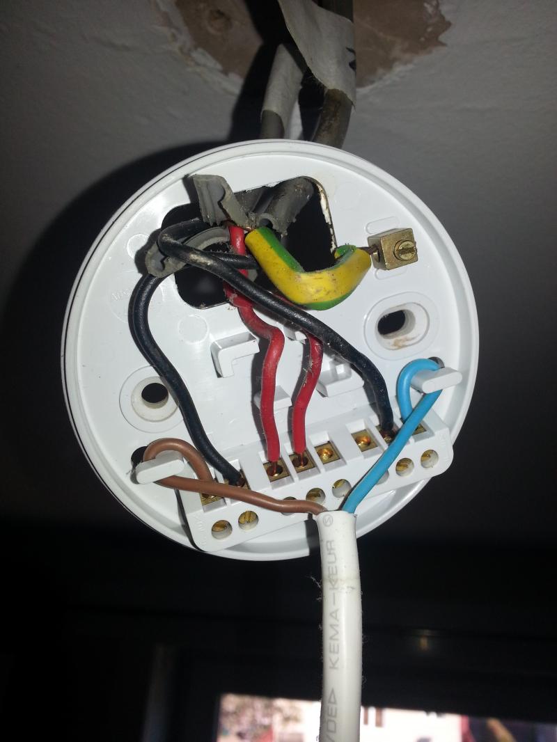

I am installing 4 12v downlights in the spare bedroom, dont flame me i need flush lights as I am making the bedroom into a cinema room.
There are two cables at the pendant, sure this heads off to the bathroom. Is it ok to remove this block from the pendant (it clips off) and wire the downlights off the two connections the pendant is currently running off? (thinking this is no different from getting a separate chocblock?

If you are going to loose that into the ceiling (and there is no access above), you will need to use a maintenance free JB similar to this:
http://www.tlc-direct.co.uk/Products/ASJ804.html?source=adwords&kw=&gclid=COKbnJXyybcCFYjLtAodtygA-g
You cannot use the strip from that pendent because:
1: It will no longer be enclosed.
2: you can not loose screw terminals above a ceiling.
3: Those terminals will fall to bits once removed from the pendent.
Even if your new downlights do not require an earth, make sure you connect the earths anyway - Most downlights will have provision for terminating the earth.
One of your existing cables will be the supply from a previous light fitting, and one will be the switch drop. It is not clear which is which - One of those blacks will be live coming back from the switch. You could hope it is the one with the brown flex, but that's not guaranteed - You should test to which it is, and then sleeve or tape it with a small piece of brown or red tape/sleeve.
nope, you have a standard, loop-in lighting circuit. Connect the two reds together in a connector block, then connect your downlights to the two blacks (the one next to the brown needs a bit of sleeving as this is switched live)
Enclose all your connections in a junction box and job done
Thanks, I will see what boxes screwfix has.
I have another question regarding my transformers, they have a cable hardwired for power in. Whats the best way to connect this to my 1.5mm twin/earth? (I will keep the earth continuality.)
again, a MF junction box.
