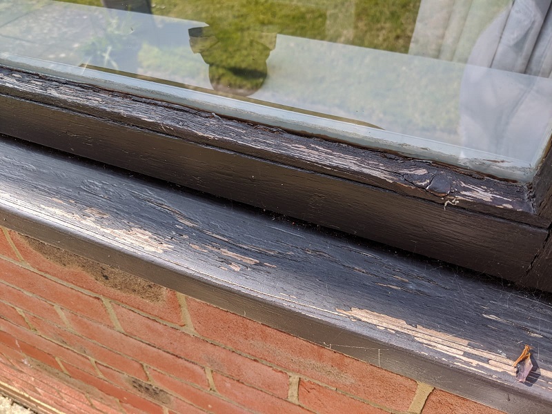

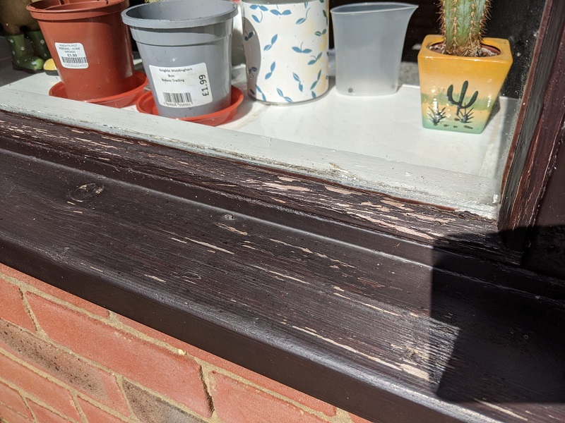

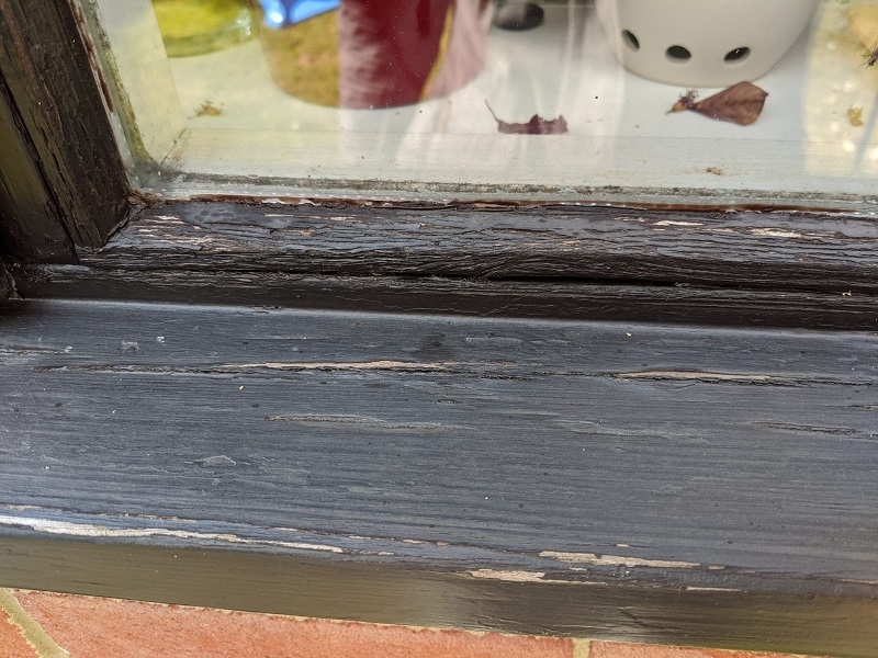

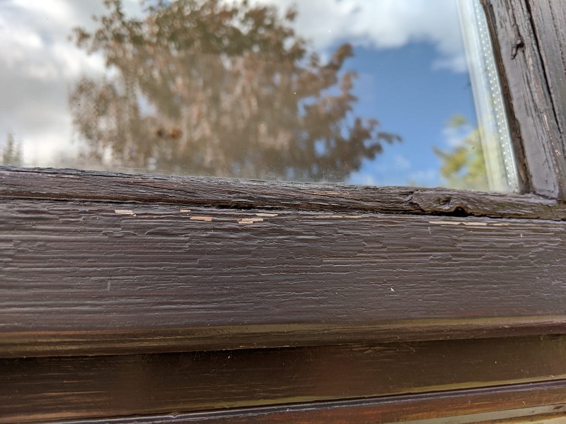

Hello,
I have some external wooden windows that are about 20 years old and south facing. I believe they are sun damaged, or have just been weathered over the years, and do at least need a lick of paint if not more. I’ve attached some photos but am at a loss about how to approach a repair. Do I need a filler of some sort to fill in the cracks, sand then down, and then a paint? Any products, brands or method advice would be appreciated. Thanks.

The paint is pretty ropey, so scrape and sand off to expose the timber beneath and re-inspect. If there are signs of rot in areas (punky or soft timber which can easily be dug out with a blunt screwdriver) the affected areas should be raked out with as wire brush, treated with a wood hardener (such as Bonda Wood Hardener) then filled with a 2-pack wood filler, sanding off to finish. Repaint the lot afterwards

Good morning aex, do the wood repairs as jobandknock suggested. Your windows have been stained with a mahogany colour. Sand down rigorously to get back to the wood. Sikkens basecoat of rosewood and 2 topcoats will bring them back to new. As for the glass, the units have failed, simply replace the affected ones the windows should be good for another 10 years. Sikkens web site will direct you to your local stockists. Hope this helps.

Thanks for the response and for the colour tip. Finding the sikkens paint in stores is challenging at the moment. Would this alternative be ok? and could this be applied directly to wood as a primer and then given the extra 2 coats of same product? https://www.screwfix.com/p/ronseal-exterior-woodstain-satin-deep-mahogany-750ml/895fg

I personally would only recommend Sikkens, used it for over 15 years with nothing but praise. There maybe others on here that can recommend ronseal. Sorry only endorse products I have used and trust.
