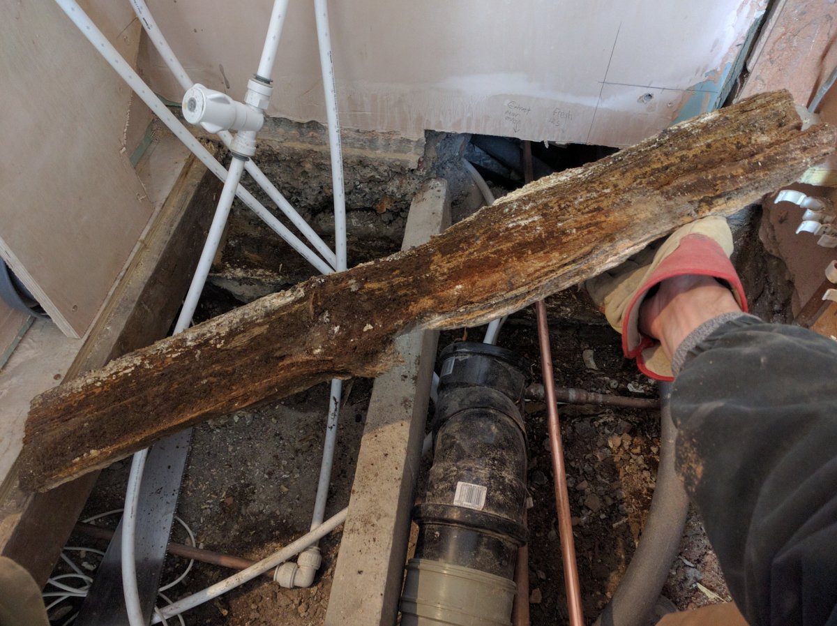

I have a small office room on the ground floor and the ends of all the joists have been damaged by wet rot.
I solved the water problem a couple of years ago but now I need to fix the damage to the joists.
Having Google'd there look to be four options - replace the joists, sister them, use plates to bolt a new end in or use the angle brackets.
I think I've ruled out replacing them completely because it seems like a total ballache. Sistering seems like it would be difficult because I would need to cut wider pockets into the wall.
What's the best way out of the other two methods? Have I missed something?

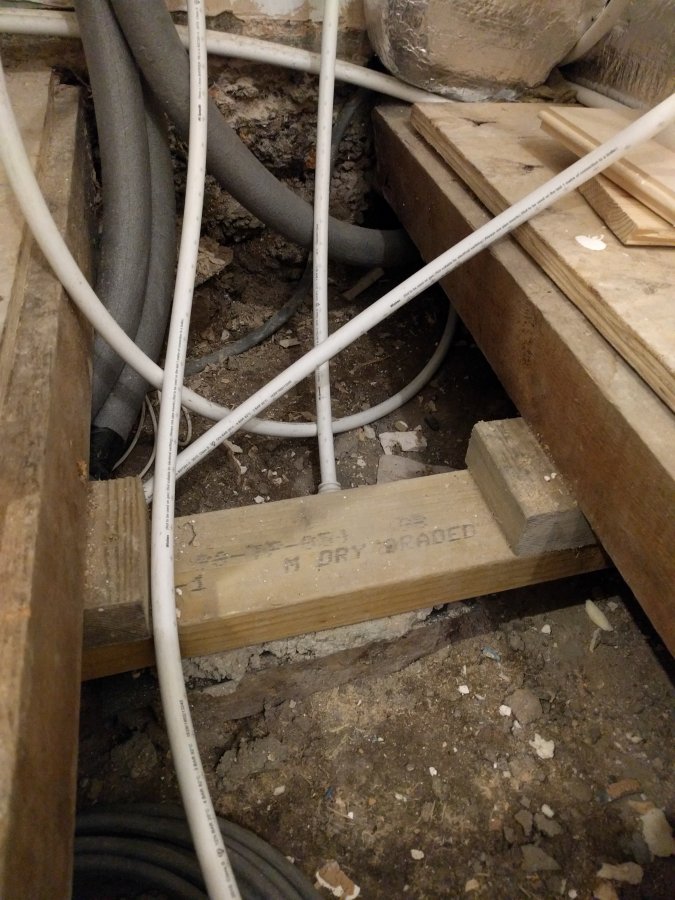

I think I might go the sistering route, I'm assuming I'd need to jack the joists slightly to get the bowerbeams in and I'm a bit worried about the two concrete block partition walls that are currently sat directly on the floorboards.
I'm planning to lift the floor in the next couple of weeks then take a final decision because I've not seen the ends for myself yet (only advised by the electrician who did my rewire and by the state of the skirting on that wall).
