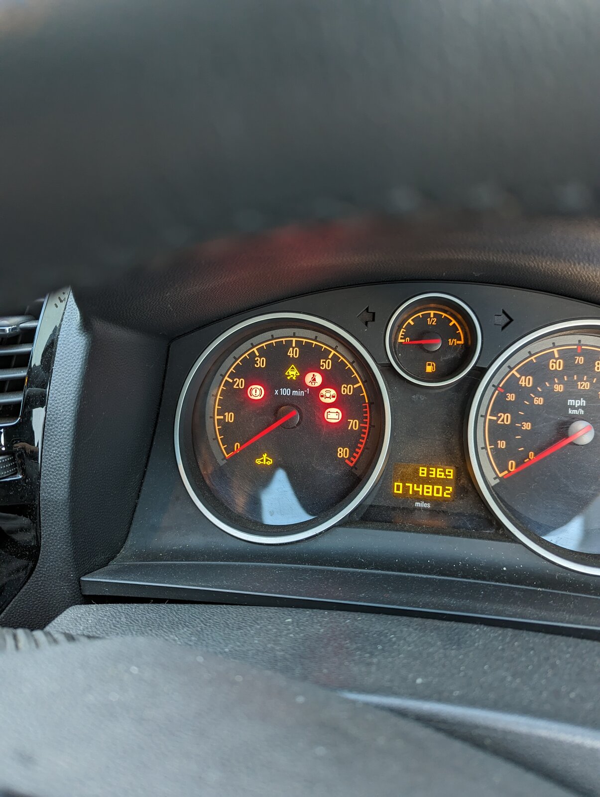

I needed to check a fuse as my boot wasn't opening on my Vauxhall Zafira (2013). I removed the engine electronics fuse by mistake, but replaced it immediately. The car now won't turn over at all. There is just a click from the engine when I turn the key. Any idea what I can do? I've checked the fuse and it's fine. I tried another fuse in it's place and it still won't turn over.
Everything else is working, central locking and lights. I've attached a photo of the dashboard when I put the key in.
Any help would be appreciated. There were no problems before I took the fuse out and put it back in!

Check battery terminals are on tight.
Sounds like battery or starter motor / cable trouble. Try jump leads to eliminate battery
Sometimes if the battery is on its last legs and you are working in it for a while with the door/boot open and an interior light on, it drains the last drop out of the battery. As said, try jump starting it.
