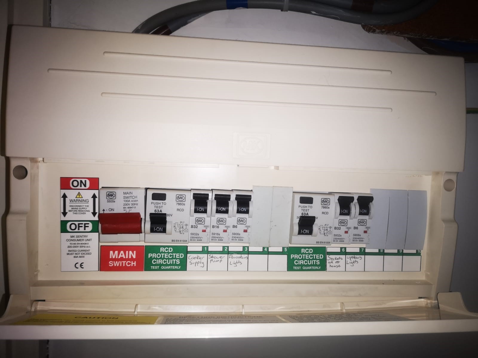

Hi,
My son is having a bathroom refurbishment, this involves removing a wall between the bathroom and a toilet to turn two rooms into one, repositioning the lights and light switches and making provision for a washing machine to be installed in the new bathroom.
The builder has told him that because his consumer unit is plastic and not metal it needs to be replaced because, if the house is sold in the near future it will need to have an up to date electrical safety certificate and the plastic consumer unit will make it fail.
Photo of the existing dual RCD consumer unit:
The builder has quoted over £1000 to replace this CU. Does it need to be replaced to allow the electrical work in the bathroom to proceed or is the builder just fishing for extra work?

It does not have to be replaced just because it is plastic.
Also nothing to do with selling the property.
That was my opinion also, but does it need to be replaced to allow the bathroom work to take place? If the bathroom changes can be done, legally and compliantly, without changing the CU then my son needs to know that he has that option.
I wouldn't think so.
What changes are going to be made?
He doesn't need a new CU to remove a wall.
Every circuit has an RCD protecting it. Only five circuits too not a great deal to worry about even though it's a plastic consumer unit.

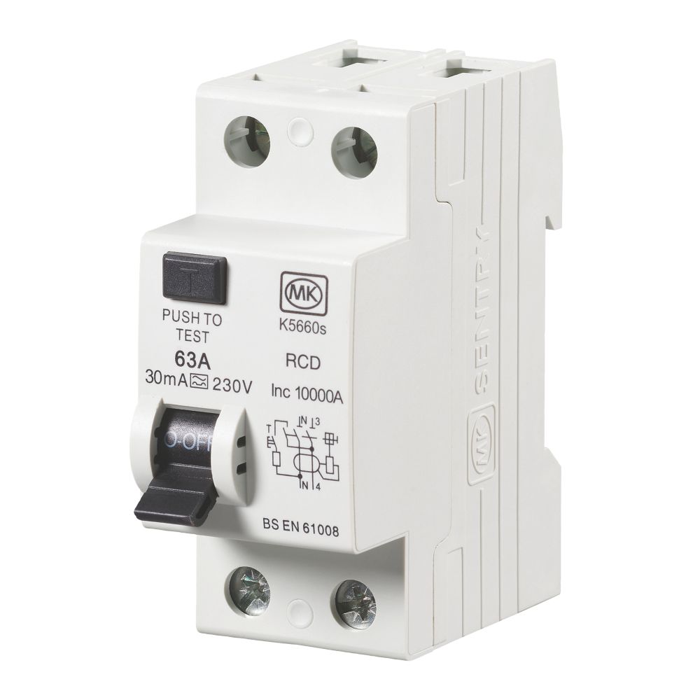

Those RCDs are Type AC which is not permitted for any new or extended circuits.
However one or both could easily be replaced with a Type A for a fraction of the cost of a new consumer unit.
The fact it's plastic doesn't change anything.
Houses do not need any electrical certificate when being sold.
Even if one was obtained, there is no 'fail' just because it's plastic.
Certainly not compliant with current version of BS7671 if a new circuit. but, as for ...
