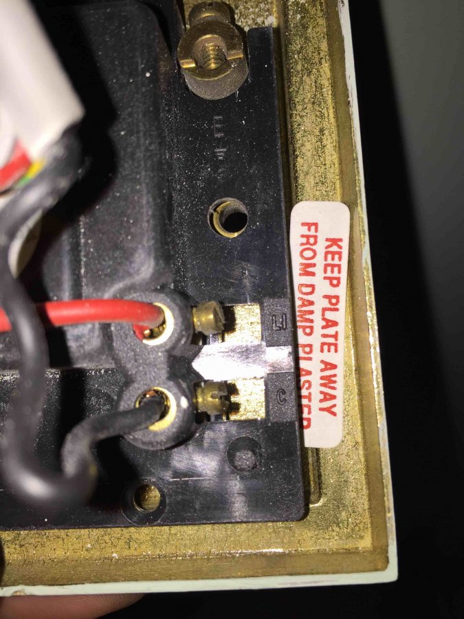

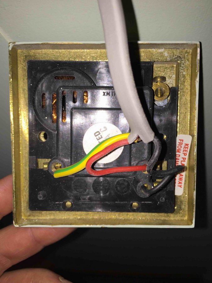

Hi
I am changing an old gold dimmer switch for a more modern brushed steel dimmer switch but am confused with the wiring i've found. Both dimmers are push on/off and twist to dim. There is only 1 single dimmer switch controlling the light. Can you help?
I found the following (pics attached): -
red connected to L1
black connected to C
yellow / green (earth?) connected to L2
As this is a replacement only the instructions tell me to wire the same way as found except earth as per instructions. The earth connection to L2 is confusing me
Can anyone advise?
thanks

Ok, well that's somewhat less concerning then.
But really, you want a multimeter to verify that, that earth is actually an earth. It's likely just a case some moron has put it in the wrong terminal.
If you can get your hands on a multimeter set to continuity (Ω), with the power off, test between that earth at the switch and that at the light fitting - you will very likely need to use something conductive to extend the reach. If you have a spare bit of flex you can use that with the help of an assistant.
I would be very wary doing anything until the wiring has been verified.
The person who fitted that was a dangerous idiot. You should probably assume that they have done other equally dangerous things elsewhere in your house. Get the whole place checked by a competent electrician ASAP.

I thought that, but I wouldn't be happy advising it was ok to connect up based on a photo of the rose, given how wrong the switch was and there's no guarantee there's no JB. Chances are if the rose is ok, the earth is ok, but I wouldn't want to risk it

It looks like a wiring mistake, the earth must go into the Earth terminal, not the L1 or L2 terminals.
At present you do not appear to have an earth to your dimmer, unless the back box is earthed steel.

There is only 1 earth wire (mistakenly(?) connected to L2). There is nothing connected to the existing switch earth terminal (picture 1 top right) and I cannot see anything else connected to the box which appears to be plastic not metal so guess you're right, currently not earthed.
Regarding mismatch comment..... I am replacing an existing gold dimmer switch with a new silver one and the light currently works and dims ok (notwithstanding the wiring anomaly!) so assuming this will be ok
Have also checked a couple of other single dimmers in the house and both have red to C, black to L1 and Earth connected to E and again no earth connected to back box which again appear to be plastic.
Hopefully just a one-off mistake....
