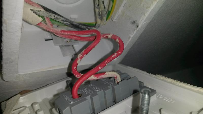

Trying to fit a single dimmer switch - but then when opened up current light switch found:
two red wires
One brown wire
one green/yellow wire.

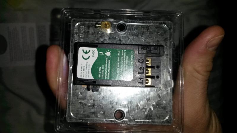

Instructions say that the red wires need to connect to the dimmer L1 and C connections - this makes sense.
Problem lies when I'm told that the earth wire needs to be connected to the metal plate of the dimmer - that I guess is the Green/Yellow wire.

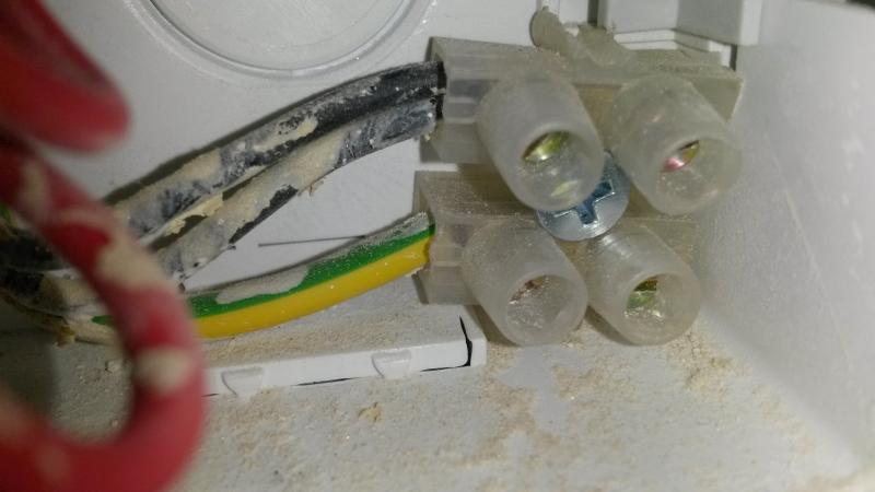

The green/yellow and the brown were both connected to a small plastic block inside the plastic switch box.

So that would suggest com is perm live and L1 is switch line to lamp.
Then brown core is concern with regards to colour, possibly someone either trying to make safe a redundant part of circuit or it could be offering continuity to another part of the light circuit, does this brown cable by any chance go directly through wall to reverse of wall switch?
You still need to confirm whether the lamps/any transformers are compatible with the dimmer.
I don't see any browns in that picture just reds, black and green/yellow.
Thats right.
I thought it was brown but the camera obviously has brought the black out. My fault!!
Leave the black wires as they are.
Connect the green and yellow wires to the earth terminal on the faceplate.
So basically reda go to l1 and c.. while greenyellow goes to metal plate at back of switch.
And then just leave the blacks where they are?
It looks like there's two earth wires within the green and yellow sleeve.
Make sure both earth wires enter the earth terminal. And check first the ends aren't brittle. If they are, cut the very ends off so you have nice strong ends.
