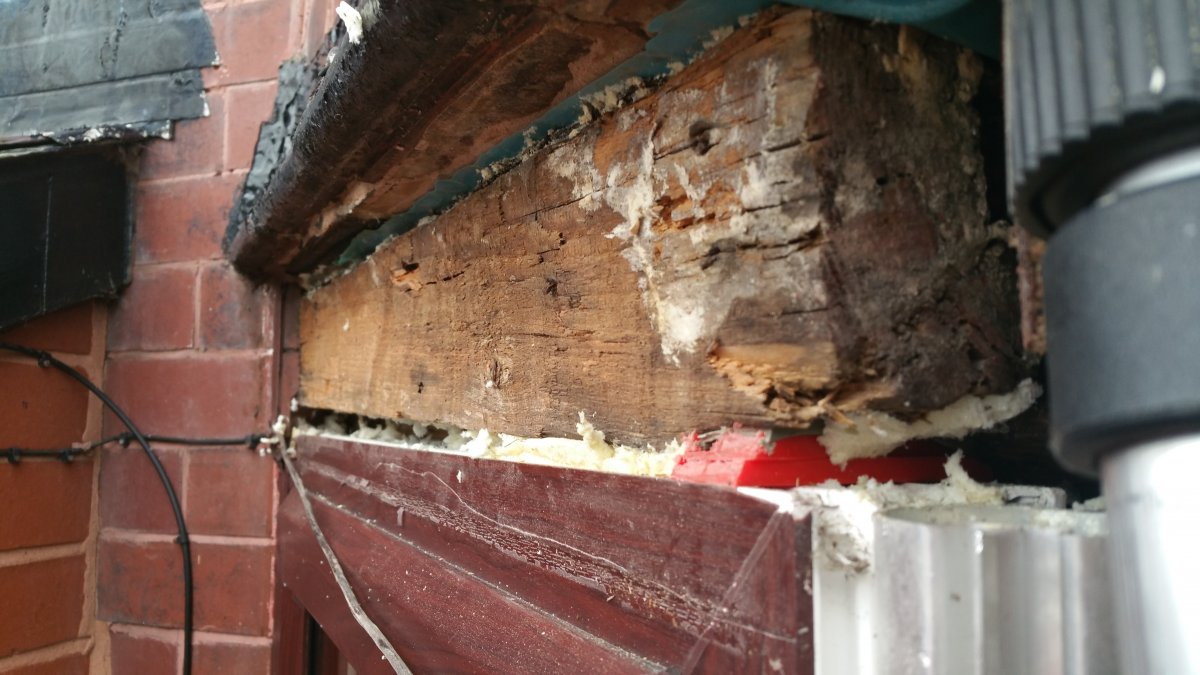

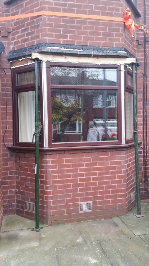

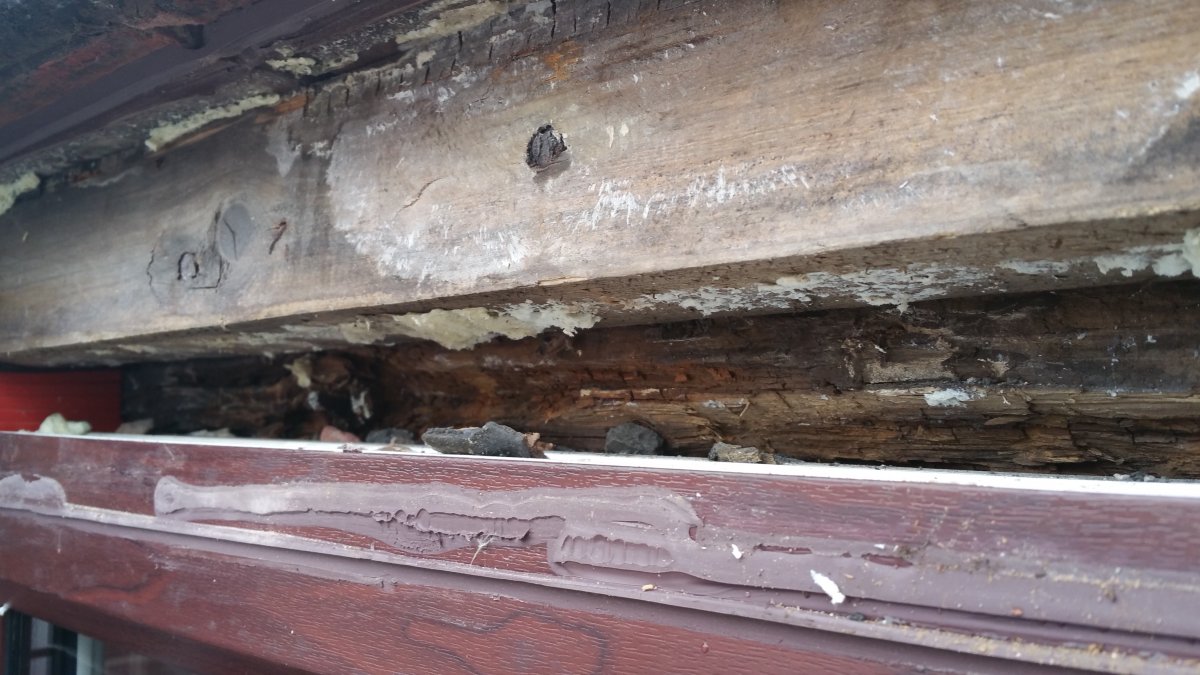

How not to install a bay, a job I was called to to survey for the reason the barrel had dropped, removed the fascia trim to reveal this

Wow that is ... s**t.
So the fitters have gone to all the expense of rocking up with a new set of windows, removed the old, kept the rotten old headers and completely ignored any requirement for load bearing.
If you keep the old headers (which are part of the frame) - can I assume a spreader plate at the angled join of each header, will spread the load down to where the top of the bay pole jack presses ?
The old window headers were removed, what we found was the old timber lintel probably an 8x4 lay on its side had rotted out or at least the forward 4 inch of it so the installers hacked away at it to remove the rot and nailed some timber they found by the looks of it to the remaining timber lintel. You might think that's OK but what you have left is a lintel who's ends aren't supported and because its now only half the width it has fell in behind the window frame and is being pushed through the lounge ceiling, the lintel is 8 or 9 inches wide because it supports the internal skin of the barrel, normally these are single skin stud work with bricks laid in between but this one has a cavity and full width window boards inside, what we have now is the internal skin resting down on the rotten lintel which in turn has fell inside the downstairs bay and is coming through the ceiling.
The outer barrel is coming away from the house and was close to falling into the front garden, left 3 acros on site with 4 x 2 holding the barrel up and had to ratchet strap it back to the house to be safe
:sick:
Im guessing the window company have done a runner then and this is an insurance job?
Wow even s***er, people have been killed by falling bays ! very dangerous.
Thanks for sharing, its laughable to see where they have used packers (obviously funny not, for the poor householder).
I do moan a bit about the cost of the insurance sometimes but then you see something like this :eek:
A £40-50 insurance policy and they will probably have to pay out thousands on something like this, It is a good thing FENSA are forcing company's to issue insurance really.
I just hope that company haven't done alot of bays.

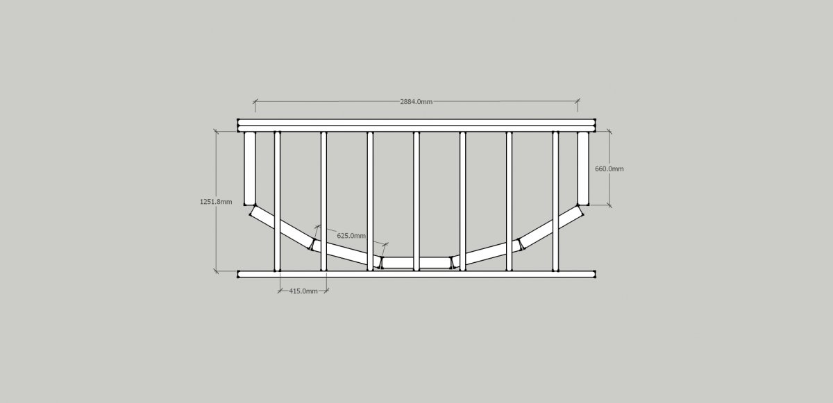

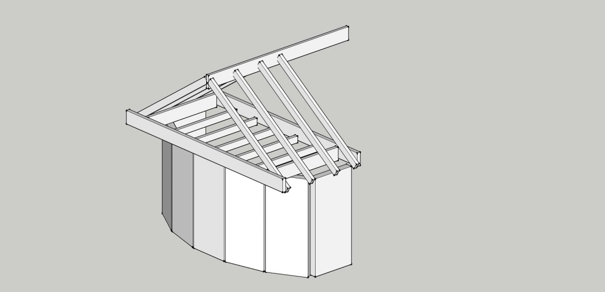

Attached is a CAD image looking down on the Bay Canopy structure, which supports a tiled roof, the outer most facets have a 120 degree angle with the return facet - what sort of spreader plate would you use under the retained headers, Window Widgets referred me to Duraflex (whose windows these will be) they can sell me a 3mm thick, 120-150 degree stainless steel spreader - would you be happy with just that or would you suggest something more elaborate, I am concerned the bearing wont be sufficient.

Here is a CAD of the shim plate, is 3mm thick enough to bridge the gap between headers ?
