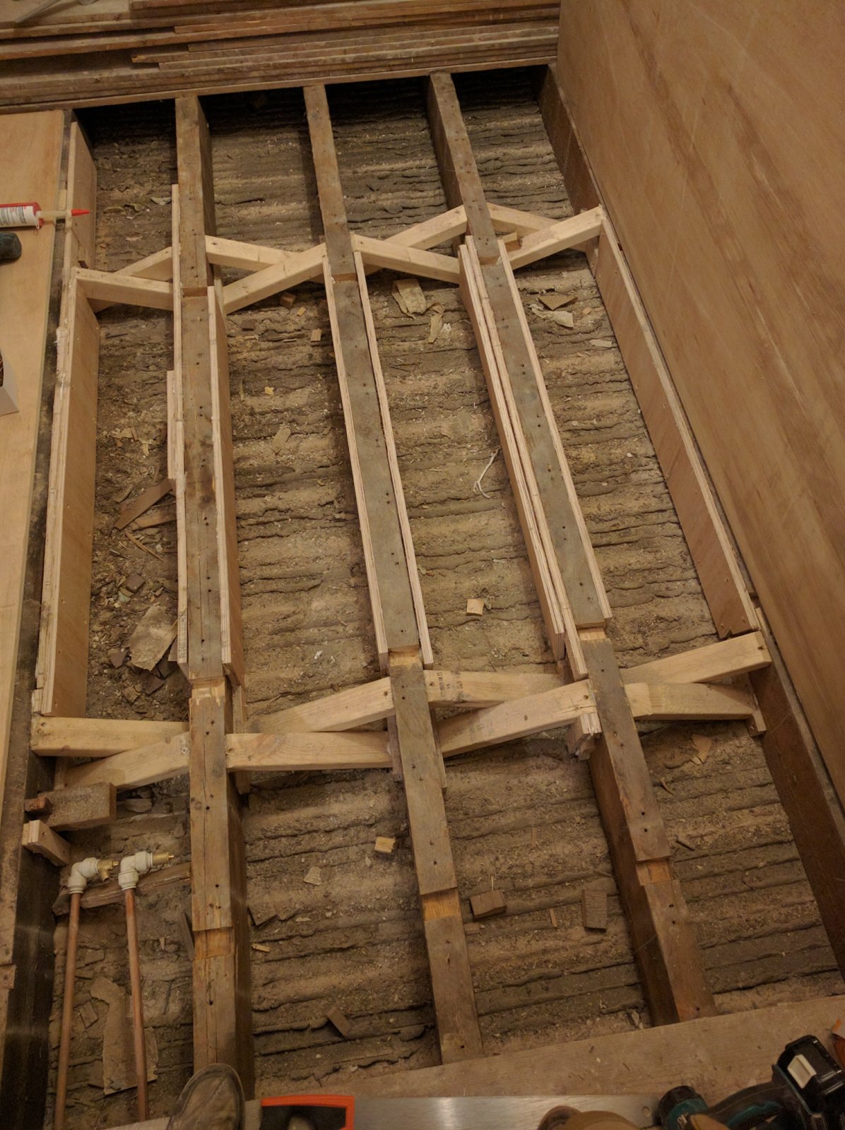

You could double up some of the original joists especially around the bath and add a new wall plate.
While your ceiling is down consider glue and screw plywood to the bottom. The bottom and top edge is the most critical for bounce hence why I beams exist. Then do the same on top without the glue.
In my case I also glued long strips to the sides of the joists nearly as high as the joists.
It wasn't cheap though in materials or time.
I'm not sure how much of it is placebo effect but the difference seems immense.

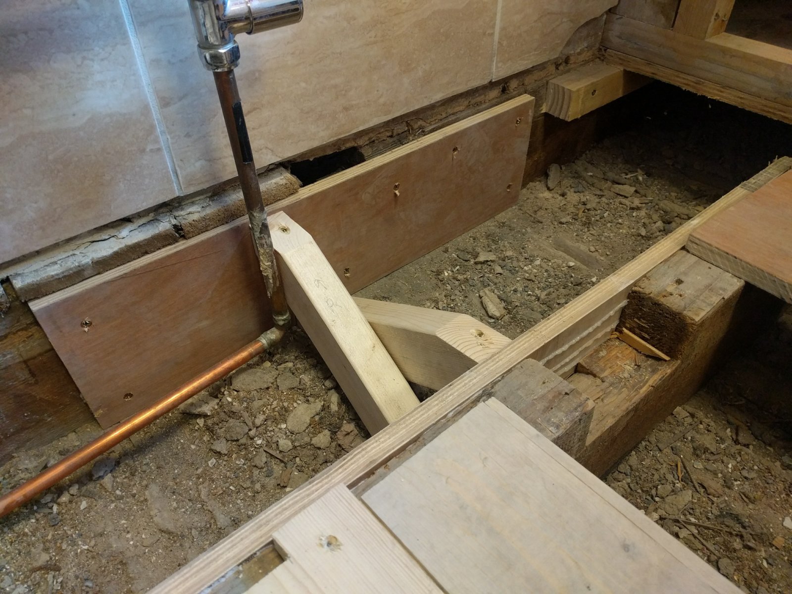

Of course I didn't want to replace the joists so that was the best I could do with the existing over notched joists.
herringbone strutting stiffens a floor. Noggins are just for supporting cut floorboards.
Herringbones push against the adjacent joist, if one joist tries to bend, as they are diagonal. They have to be quite tight.
You mention taking the floor up. If you lay the largest sheets of 18mm WBP ply that you can carry, and screw them down tightly, they will form a deck with the joists and again, make it more rigid. Have the biggest pieces in the middle, and do your cutting and trimming to fit the edges. Do all your wiring and plumbing first. IMO it is better to use square-edge as it can be lifted easier in case of need, without having to saw through tongues or cut traps. opinion may differ on this.
I have not tried a lower deck on the underside of the joists but it sounds plausible. You can add dense mineral wool batts while you are about it, between the joists, to help muffle noise.
Verify that all the joist ends are firm in the wall. You can foam into small gaps to stop draughts.
You can use timber preservative against rot and worm, especially in the bathroom and kitchen which may have overflows.
If you have bad notching of the joists, post photos on here.
If the other ends of the joists are embedded in the wall, you might not have enough wiggle room at the 'header' end to use joist hangers (and get them level), so you may just have to renew the header plate, are you able to pass a bolt through the wall, if not perhaps you could resin and threaded bar to secure it to the wall.
Oh yes JohnD has a good point about struts, the reason I started adding plywood to the sides was to add strutting without disturbing the ceiling. However measuring it all out was a massive pain so I'm not sure I'd recommend my way.
Let me find a photo of my efforts
