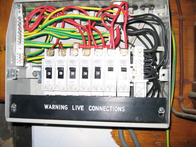

Thanks Breezer, I guess it was obvious. Here is a photo of the inside of the CU. Unfortunately because of the flash it's a bit bright. The relevant MCB is second from the right. You can't see because of the flash but it is 15 amp. And there are TWO red wires going in, which suggests to me this is a ring! Which can't be right...can it?
It's all 2.5mm cable.
The CU is made by MK.
Any help gratefully received.

ok there is something odd about that CU
i see no main switch?!
is there a main switch placed seperately or something?
also that CU is an old style MK they do sell a retrofit kit though to allow you to use modern MK mcbs in them
Is that pyro I see on the right? What part does that play in the installation?
EDIT - no it's not, is it. Now that I see where it is, and peer at the screen through the right part of my glasses, I can see the ribbing on them. Sorry 'bout that... :oops:
Also I note that that 45A MCB is not at the end of the busbar closest to where the incomers are....

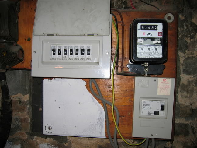

Here is a pic of the setup on the outside of the CU. THere is a separate RCD switch on the right - hence I was brave enough to open the CU.
On the outside of the CU there is a sticker with writing on it, which says that the system was checked in 1994. God knows who by, though.

Not necessarily - I'm sure we'll get the circuitry identified, and that misplaced MCB will be easy to move...

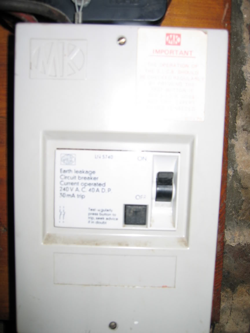

Wouldn't have done you much good if you'd formed a live-neutral fault path, but we won't dwell on that. Would be interested to see a close up of the RCD - is it an old voltage-operated type?
Secondly, can you confirm the path that the tails take? The service head is just visible on the left - I guess they come from there, into the meter and out to the RCD, but it does look as though they curve downwards into the RCD enclosure.
#3 - where's the main earth connection? Is there something above the CU, hidden by the open lid?
#4 - what are those unsheathed conductors disappearing behind the mounting board above the meter?
#5 - it's probably just the combination of camera angle and twisted wires, but it looks as though the rightmost MCB has 2 conductors of different sizes coming from it...

The tails do indeed come fromt he service head above the CU then down through a tight squeeze below the metre into the RCD. Then up from the RCD into the metre (just visible in the photo). Then presumably the two grey wires take the feed into the CU from below. You are right, it does look odd in the picture but that is just the tight fit.
As for the main earth connection, um, I'm afraid I'm not sure what I should be looking for. As you can see from the new pic below of the overall arrangement, there's an earth wire coming out of the top of the CU which disappears to the left. It then vanishes behind some plasterboard - could the main earth connection be behind that (this is all in the cellar - behind the plasterboard is the rubble/foundations of the front of the house).
The unsheathed conductors...I wish I knew. They don't disappear, they just stop and have been bent up "out of the way". I haven't dared touch them. They run off with another 2.5mm cable (A), and disappear into the floor above. I am assuming that they were originally one end of a ring which the muppets who lived here before disconnected, then connecting up the ring with a new cable (B) (A and B both go into a 30 amp MCB).
As for the rightmost MCB - since reading your comment about live-neutral faults I am a little wary of opening it up again! But I think that is just the camera angle - from what I remember there was only one wire going into that MCB - 15amp for the boiler.
Phew! And here also is a pic of the RCD close up. I feel quite ashamed by the extraordinarily shambolic state of our electrics.

your RCD is only rated at 40amps? and you have a shower or other appliance running on a 45 amp breaker. I would recomend the RCD be changed to a higher rated one.
