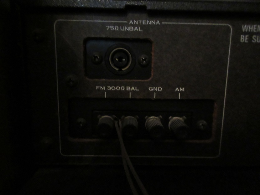

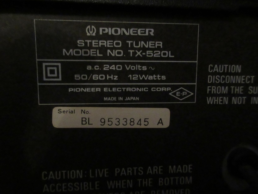

Hello, I have a rather old pioneer stereo tuner model no tx-520L, see photos.
Those two cords you see coming out the bottom are supplying radio through a corded antenna but there is a lot of interference. I would to replace it with a surface mounted antenna. What can I use here that will give the best quality reception?
"Best quality" would be a roof mounted multi-element FM aerial aligned on a specific transmitter. After that it's a dipole aerial which picks up from all around. Next down would be the same things but mounted in your loft.AAll of these connect to the 75 Ohm input.
After those options you're looking at something in the same room as the tuner. The usual choice is a ribbon aerial. That's basically a wire ribbon in the shape of a letter T. This is what you'd connect to the 300 Ohm input.
Ribbons can work well in medium to strong signal areas. They take a bit of faffing around to get them lined up though so it can either be great or rubbish depending on how lucky you are with the final alignment.
Aerials to avoid: Those round FM Omni aerials are poor. With a 360 degrees circular design there's only ever a few degrees of the aerial face correctly aligned to the transmitter. That means not enough metal to generate a decent noise-free signal.
Others to avoid would be the amplified aerials from Argos / Amazon / Supermarkets etc. Lots of hiss, too little signal.

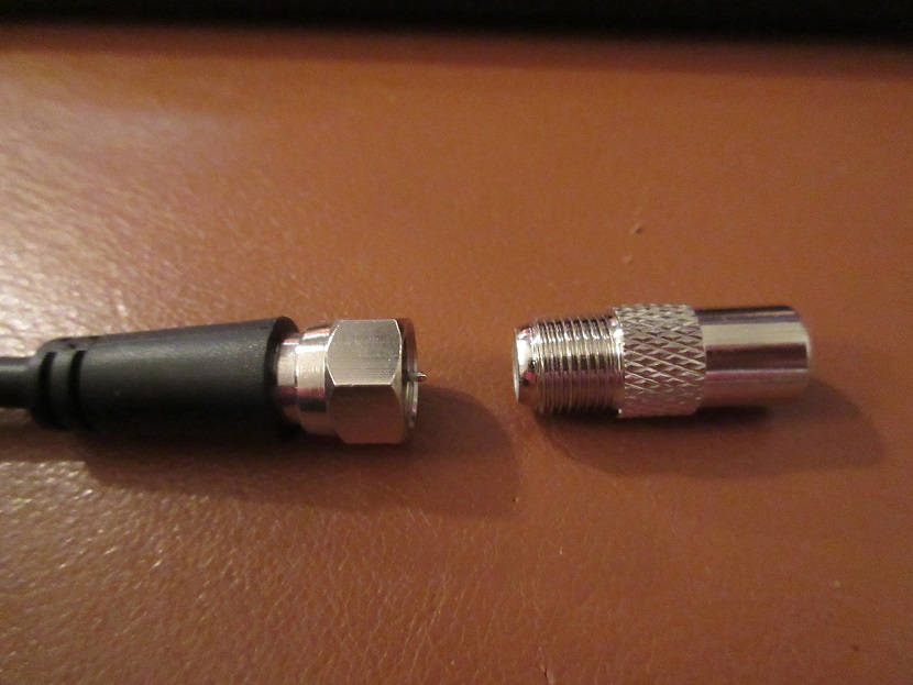

So I went out to shortly after I posted to buy some coax f plugs, see photos:

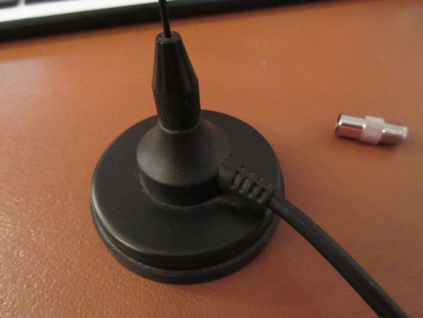

We have the use of another FM aerial (see above) purchased a year or two ago online and it works ok, so I tried it.
It barely picks up any signal at all, tried a lot of twiddling but very little luck. A few stations but not the ones wanted. Surprised it worked at all to be honest.
Can't do roof mounting here, just not an option.
So the 300ohm ribbons are the only option? Is there not something else that looks a little more substantial like in the photo above but which works as well as a ribbon ?

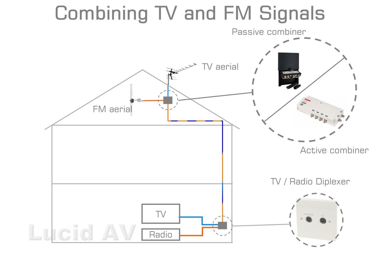

The questions about your loft and current aerial layout were leading towards a suggestion of adding a loft mounted FM aerial and combining its signal with that from the TV aerial. This is the idea
Obviously for most DIYers this is only practical if the TV aerial cable comes in to the loft so that a splice can be made to fit a combiner. Hence all the questions. But if that is the case then the solution above will give you really good results.
The combiner could be a simple passive (non-powered) device, or it could be a simple loft amplifier with a UHF (TV aerial) and VHF (FM/DAB aerial) input. The output of either device is the combined signal from both aerials. This works because FM signals and TV signals work at different frequency ranges, so although they come down the same bit of coax they don't interfere with each other.
The signals are split back on to their separate forms by an outlet plate with sockets for TV and FM/DAB/Radio. The plate is a filter, so there's a bit of circuitry on the back but it doesn't need power.
Passive combiners are roughly £20. Active loft amps with FM and TV input combining start roughly £25. The outlet plates are somewhere in the region of £8.
By all means try the passive splitter you linked to in the previous post. It's cheap enough not to break the bank.
