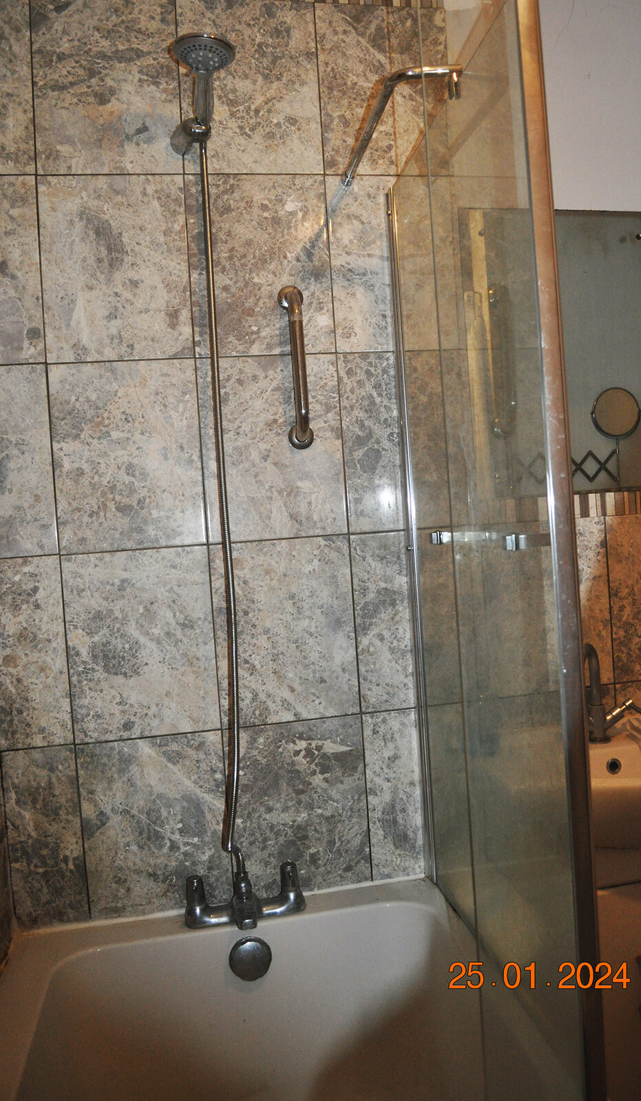

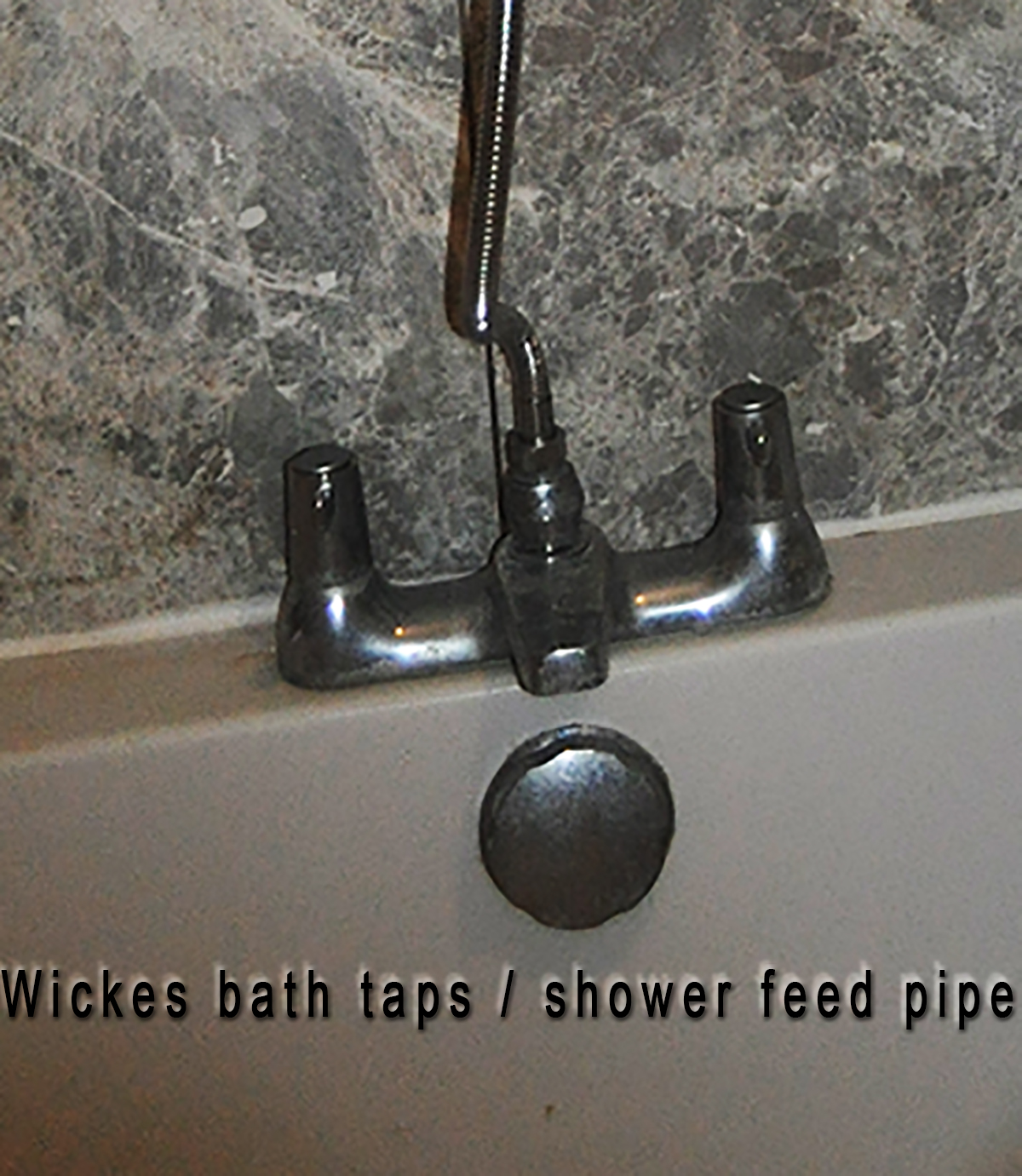

I’m looking to replace my current Wickes bath mounted mixer-tap shower head arrangement with a DIY fit-able thermostatic shower that would include some sort of flow adjustment on the wall at, say, chest height. The idea being to take a shower with a guaranteed temperature, irrespective of the vagaries of mains water pressure and the sometimes unpredictable hot water flow from my elderly Worcester Bosch boiler. I am sure there will be dozens of suitable pieces of fancy hardware to meet my requirements – no doubt the ever-watchful DiyNot overwatch-bot will be offering several in due course :)
My question concerns fitting such a replacement device: if the photos have downloaded ok, you will see the present bog standard arrangement, with the twin taps on a single mounting on the bath edge: how can I get at the pipes underneath the fitting in order to release the taps, as I can’t see the underside of the bath, hemmed in as it is by the wall? I’ve not put that very well, but I hope you can see what I’m getting at. Advice and guidance, always generously given on this forum, would be gratefully received.

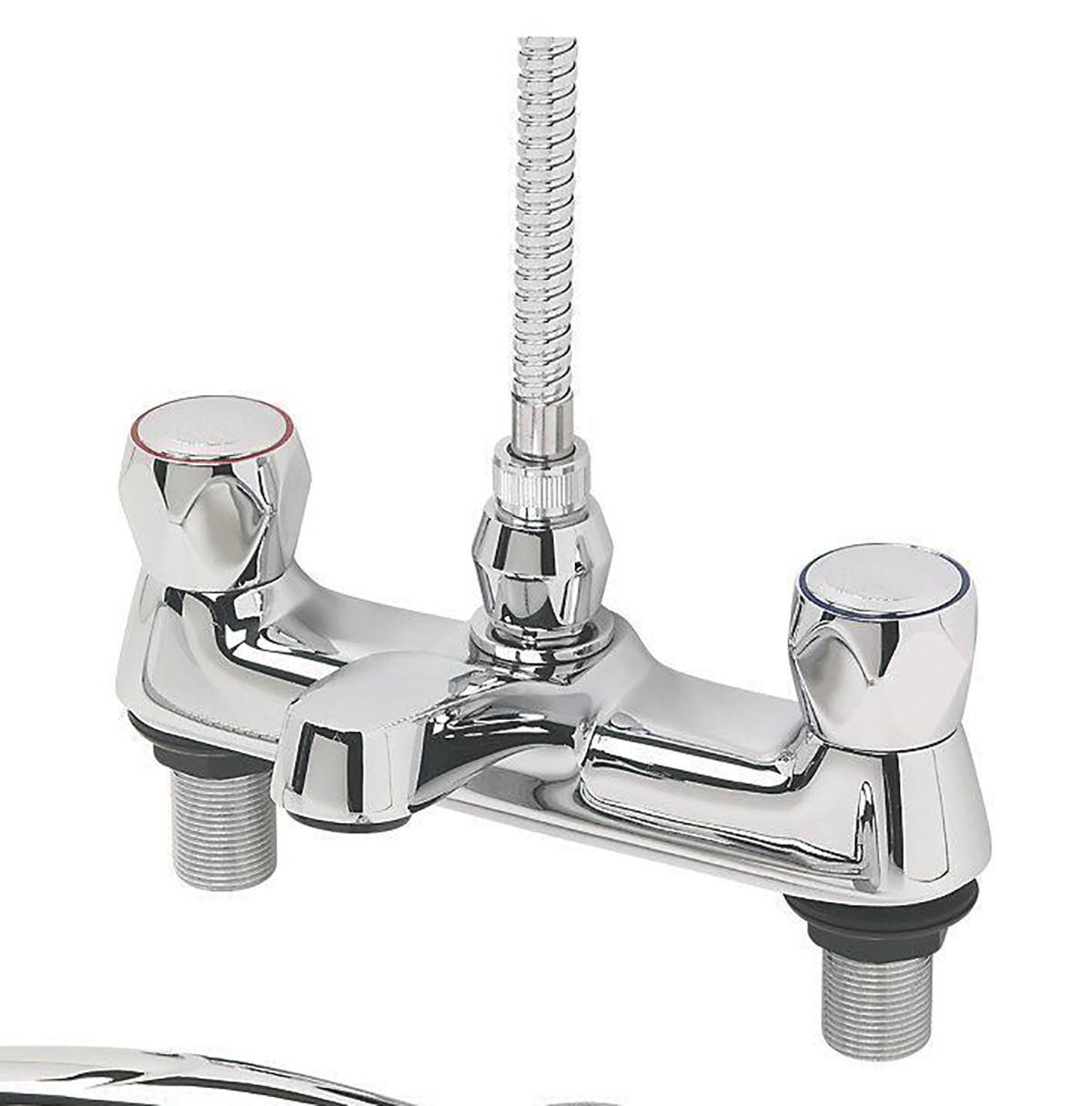

Thanks, would that mine were of that 'exposed nut' type, but it ain't: a photo of a similar brand shows the deal, with the threaded 'tails' underneath a solid non-dissamble-able block.
I'm stuffed, I think, there will be no room to get pipe wrench in what will be about 4cms gap - but how did the installation plumber do it? I need to get the panel off and see what is revealed.
" but how did the installation plumber do it? ".
Probably before the bath was pushed into place and tiles fitted, but perhaps you could manage with something like these bath tap spanner
whoah! I've not seen anything like these tube spanners for decades! I'm guessing one end would just fit over the tails once the flexi feed pipes are unscrewed and I'm just praying the installer didn't solder rigid copper feed pipes instead of stainless flexis - but he wouldn't have done that would he? ;)
