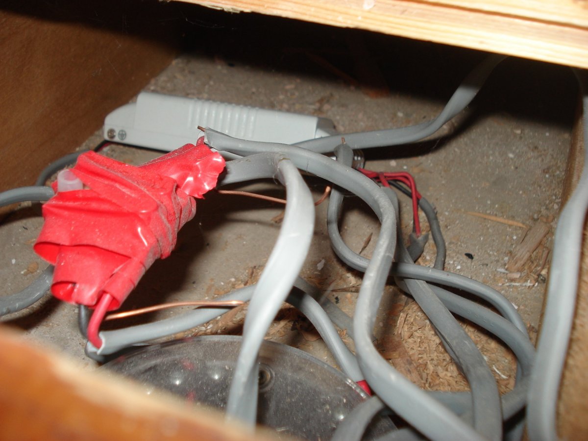

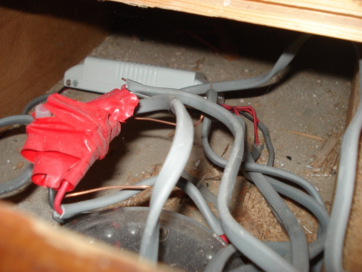

Our bathroom has 10 MR16 halogen lights. I've been replacing them with LED's and after a short while 5 of them stopped working. I've taken up the floorboards to reveal as shown in the pic. I resume the white box is the transformer and the black box is the junction box? Would it be a simple case of replacing the transformer? There's 4 wires coming out of it which is a bit confusing as I thought it would either be one to feed the junction box or five to feed the lights. Thanks for listening.

Good grief - how big a bathroom do you have that it needs 10 lights to light it up properly? :eek:
Given that mess, I would not try replacing anything until it is all sorted out and properly connected up.
OOI, what is the room above the bathroom?
Looks like it.
That might or might not be why the lights have stopped working.
Even if you find a wiring fault, the transformers might not be suitable for driving LEDs anyway.
Can't see that in the photo.
So what goes into the JB?
Are the lights split 5+5 between two supplies, or 6+4?
If your lights are ELV then you should replace the grey box (can't remember what they are called just now:sneaky:) and install a proper LED driver instead.
How many wires are there will depend on the wiring, so you'll need to deduce that. There may just be another greyboxthing serving the other lights.
General point 1. The wiring there is a right horlicks. You need to spend some time and get some proper junction boxes. All of the connections should be enclosed inside enclosures, you should not be able to see any inner conductor wires and choc block wrapped in sticky tape is a sure sign that John Wayne has galloped through there.
General point 2. It would have been a lot easier if you had gone for 230v LEDs, then you could have dispensed with greyboxthingies.

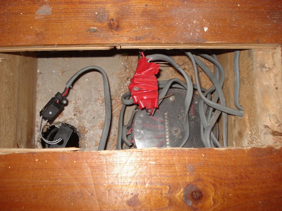

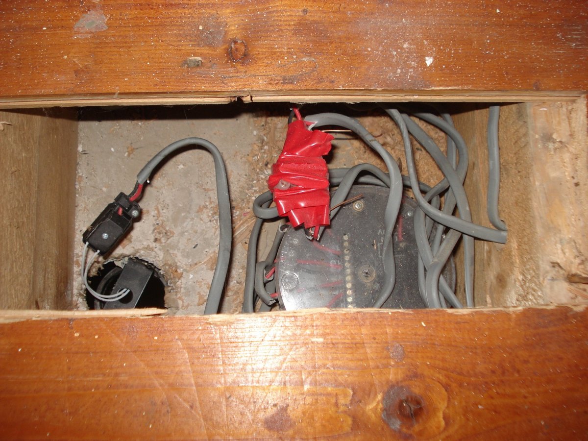

Only bought the house this year so don't blame me for the wiring chaos! It is a large bathroom but 10 lights is excessive. The junction box has five ports where the wires shoot off through the joists. I presume there is another one of these feeding the other five lights. The four wires coming out of the transformer also shoot off through the joists and not into the junction box. The bathroom is downstairs, only one half is accessible though the floorboards upstairs as the other half is under the roof. I think I will disconnect the transformer and if the other five lights still work then I will replace it, the only transformer I can find with four ports has a minimum load of 100VA though which is no good for LED's, unless I stick with halogen.

So I disconnected the white transformer ... now only one light works. Confusing. So I'm guessing the transformer powers four of the lights, the black junction box powers five (could this have its own in-built transformer?), and there's a rogue one with a life of its own. Thanks for all your replies.
Further probing... The black junction box (called a MF300) is dated 1998 - is kaput. The white transformer is dated 2013 and it works. Took one connection from the black box and inserted it into the transformer and that light worked again. So will need a new transformer to replace the black box, and job done.

The MF300 is a toroidal transformer no? Not a JB.
I would suspect, a 300va transformer at that, thus powering 5 lights quite happily
