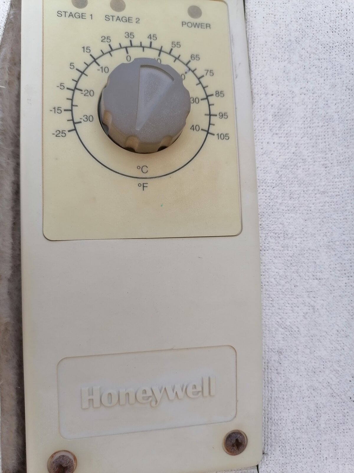

Hello guys please can I replace this kind of thermostat from honeywell to digital type I have searched for same couldn't find it's connected to package unit Tj 50-32 model please help
