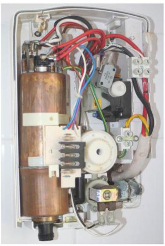

Our Gainsborough Energy 2000x 10.8kW has finally called it a day.
So we are in need of a new shower. Because the shower was a 10.8kW it has a thicker electric cable to supply it and Gainsborough advise that the following should be used in it's place.
The cable is 17mm wide.

I have attached a picture of my old shower showing cable and pipe inlets.
Can I install a new one myself (I installed the old one over 15 years ago)?
Is the cable powerful enough/ correct please?
What pitfalls should I look out for please?
Anything else?
At 17mm wide, that would indicate a cable with 10mm² conductors.
What size MCB/fuse is in the consumer unit for that circuit?
If it was supplying the 10.8KW shower I would expect the cable would be big enough for the 10.5KW model.
Your shower should (must) be protected by a 30mA RCD. Is it?

Just had a look at the Consumer Unit and the fuse/UCB states B 50.
Hope this helps.
A 10.5KW shower pulls around 45amps. Assuming the cable is installed properly (e.g. not going through thermal insulation, etc) it is rated at 53A ish).
The 50A MCB is correct, so you are fine to go for the 10.5KW shower.

So you do not have any earth leakage protection on the shower circuit.
This is a must have from a safety point of view.
What is needed is a 30mA double pole RCD. It can be installed at any accessible point along the shower circuit - it is usually most convenient for it to be at the consumer unit end.
The manufacturer of the shower, and the wiring regulations, require this to be fitted.
You would probably need an electrician to install this, as he/she will have the required test equipment to check that the RCD is operating correctly.
