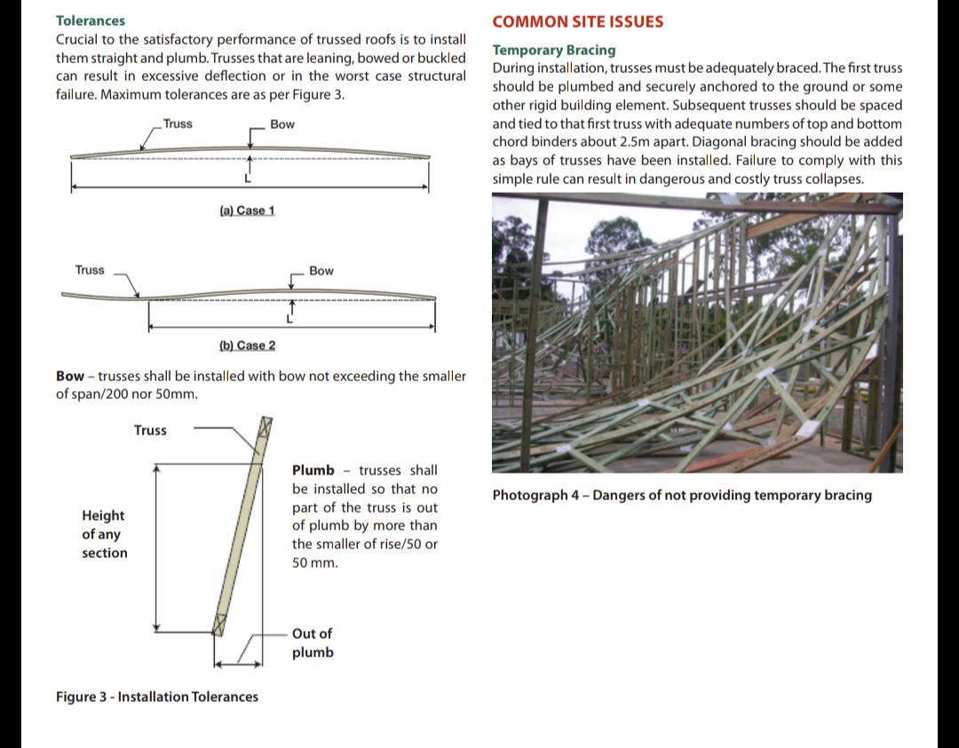

Just looking online about bowed and out of plumb trusses. Am I ready this right it's saying a roof truss can be 2 inch out if plumb and it'll still be acceptable. I can't fantom a truss being out by so much. Maybe half inch max at a guess but 50mm, surely there will be issues if it's out by that much. Maybe I'm wrong and if so, what is this 50mm out of plumb below in pic.
Below is what I understand the terms are but not familiar with Rak/b .Is there any PDF files with the truss bracing regs. Have installed many sissor trusses, attic trusses but not familiar with raised tie and it's bracing
Chv/b = Chevron bracing
Rak/b = ?
L/b= ? Left bracing
R/b =? Right bracing
