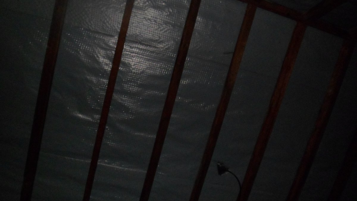

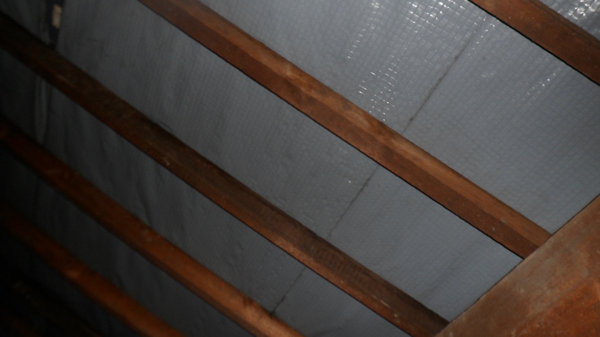

I have recently purchase my first home
The surveyor has stated the roof has a proprietary plastic membrane.
is he right? photos below
The surveyor also said the bay window area is dry lined . he wrong there no dry lining. All the doors are on upside down. which wasn't picked up in survey Should he have picked this up in the survey

The membrane is fine. It was common around 20 years ago.
Keep an eye open for condensation... There appears to be a venting system installed in one of the underlay laps. This indicates a possible issue in the past or someone forward thinking.. Then again it might be nothing. Hard to tell in the pictures

But is the surveyor right with his statement that it is proprietary plastic membrane?

No it's not propriatary. Its a standard plastic [polyethylene] membrane which came into fashion in the 80's as a potential felt alernative before breathable membranes became common.
Any house condensation issue is not related to that felt, and in most cases will be related to whoever lived in it previously

Isn't that the reinforced placcy membrane that was advertised by Geoff Capes standing on it?
Yes Jeff did stand on one and never went through. I remember the leaflet. but there were others too. this being one of them.
I cant remember the name of the product but it was marketed specifically as a roofing underlay

Condensation, it looks like a product is in use between the felt laps.. it probably needs more.

Ref the underlay, Most merchants sold it at one point.. including the now SIG branches
