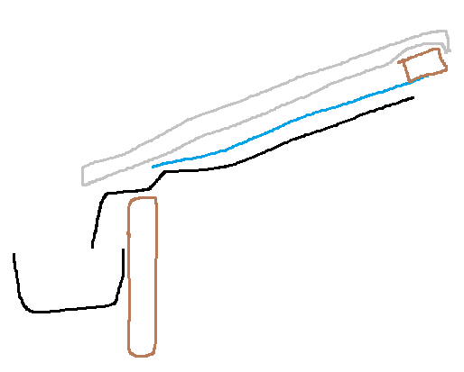

datarebal said "there is no problem". Well there are two glaring problems: one with the roof pic (that you dont seem to understand) & two with what you've written.
How will the felt "hang into the gutter" if its on top of the tray with the tile above and forward?
Felt must be left long over the fascia until your ready to cut it beyond the fascia - even on top of the tray, the felt must discharge any moisture beyond the fascia - thats elementary roofing knowledge.
What your difficulty with the fascia is I dont understand - the in-place fascia is fine.

As there are no counterbattens fitted, make sure they use nails that aren't so long they penetrate all the way through the batten and the felt, otherwise there will have been no point fitting the felt only to bang it full of holes. Also, take care with what is done on the underside of the felt; if you're insulating between the rafters, avoid pressing the felt against the underside of the battens.
Personally, I'd have fit the support trays before I fit the felt; there's always a risk that one of the "my job is just to bang the tiles on, not to think guvnor" guys will come along and tile over that felt as is, leaving a potential for water to pool there forever more; it's a job that can be done while waiting for tiles (as can plenty of other jobs on the underside)
Won't the depth of the tray be more than enough to lap the bottom of the felt, and achieve the desired outcome.

Do you mean like this, blup?
