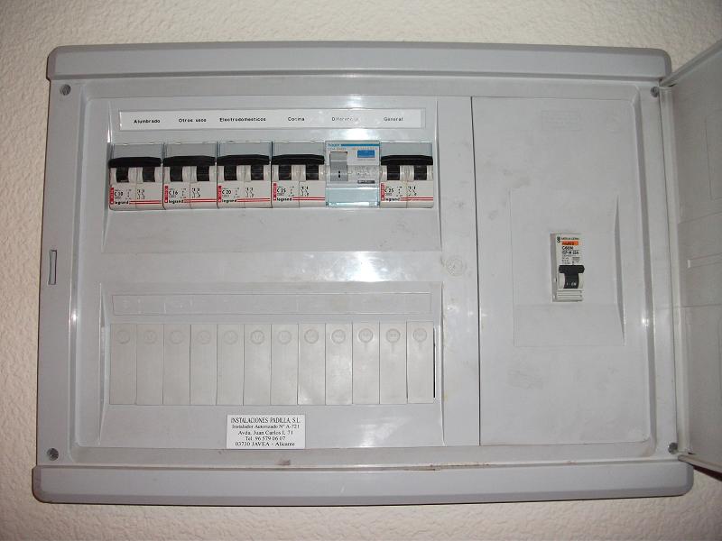

Our neighbour has a villa in Spain and we have been out quite a few times. They have an un-metered supply, with a 20amp MCB in a sealed enclosure. Quite annoying having to think about what you are doing. Oven, Water Heater, A/C in every room. You can only run two things at once and so have to think and plan what your doing all the time! Even then you trip the bloody thing a couple times a day!

Couple pics:
Consumer unit:
With trim off, showing sealing of MCB:
