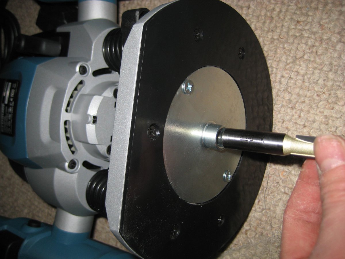

Ok today I went to fit a 3" lock in a door, I had bought all the gear to do the job - simple, so I thought ...

First question: the 1/2" Straight cutter wont fit through the Routers 16mm Bushing hole (see image below) ??
Second question: how to do you get the 3" depth - I am advised to use a 1/2" cutter for deep cutting - but cant see available and 1/2"'ers deeper that 63mm.
This is the cutter bought for the job - but wouldn't fit ...

The opening on the included bushing is just under 12mm, so where do you buy router bits that are 76mm long and the cutting blades fit through this 12mm - I have looked at other suppliers - and cant see anything. Or is the bushing wrong ??

I've got the same router, and as far as I know the 16mm bush is just for 1/4 shanks. Cutting at a depth of 3 inches is never going to work. You'd need a 4 inch cutter that would wobble all over the shop. Just use decent flat drill bits and a chisel, like you've done all your career. That's what I do.
LOL, yes I have done it many times with a chisel, and I hate doing it that way ...
The manufacturer of the jig though is spec'ing a 16mm bush with a 1/2" straight cutter (and its also an Erbauer cutter), so I'm just lost why it wont fit, there must be 16mm bushes and 1/2" cutters that work together, according to Unika ...
It has to be a 1/2" - or as you say it would wobble - or worst break and embed itself somewhere ...
Are you sure that it's a 1/2in (12.7mm) cutter that's required and not a 12mm one? I use the Trend jigs and they always seem to pair 16mm guide bushes with 12mm cutters - which is tight, but it will work - although their LOCK/JIG uses a 30mm guide bush with a 12mm cutter. As to depth of cut you are limited by the length of cutter and the plunge depth of the router (circa 75mm for my DW625). On the Trend jigs I use Wealden deep pocket cutters but even there there is a depth of cut limit and I often have to finish the last bit deeper locks with an auger bit and a chisel
