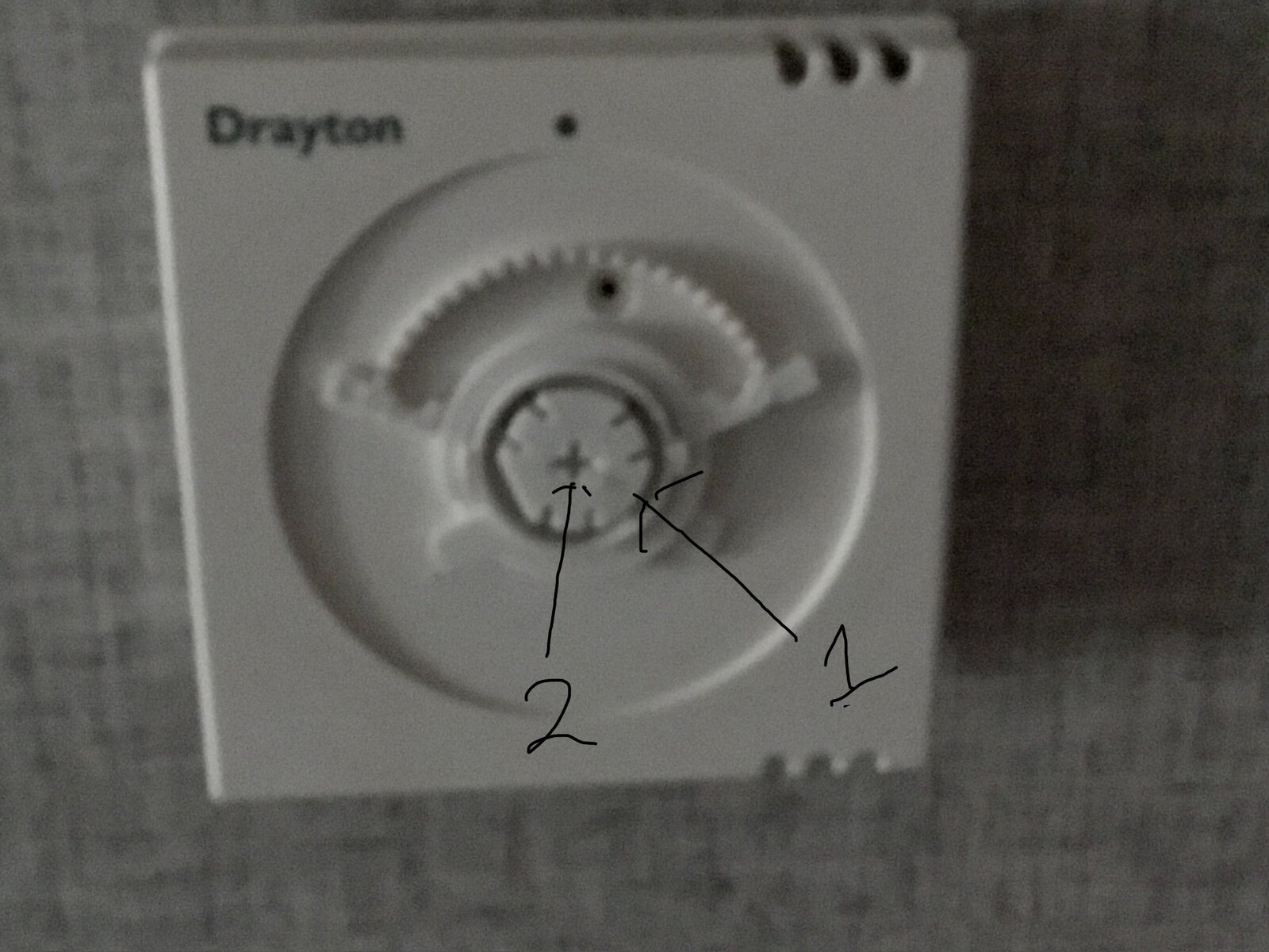

I’ve just replaced my thermostat ,,but had a silly idea .. wrong ,,, anyway issue is taken the front dial off to look inside ..should have stuck with factory settings….
any way decided to turn inner circle around with my fingers ? Thought I put it back ? Fitted it but not clicking/calling for heat tried several times took it off again? Any way saw the centre crosswas just the right size to use screwdriver and tried turning it.. yes heatings clicked on ,,,turned it to click off perfect… put the face back on tried dial no click ,,,, my fault for messing with the inner circle .. tried the centre cross again ..works .. …..am I doing something wrong/ I kno now I should have kept my hands off .. any ideas ?
Not sure why you’ve posted in forum information. Anyway, does it not click at all with the cover on? Is the power back on or did you not turn it off?
Have you unintentionally moved the limit settings?
Expand them to their widest range, and then replace the dial.
Example here...
Example here...
No mate,
what I did was turn the number 1 outer ring around ?Dont know why but anyway ,put dial face back on wouldn’t click? So took off and had a brain wave of turning no2 inner ring around with a screwdriver and it clicked started boiler/heating perfect ,, tried to turn no1 agin no click? Should they turn together ? No2 will call for heat
Came of an ideal boiler just wondering now if I messed up with the live ? Followed instructions,,,? The Drayton thermostat has 3 wire points /connections. N. L .SWITCH,
on the (. boiler ) thermostat terminal one was permanent live so put red wire in ,,,the other I put into the 3rd point/switch on the Drayton,the neutral explained itself
